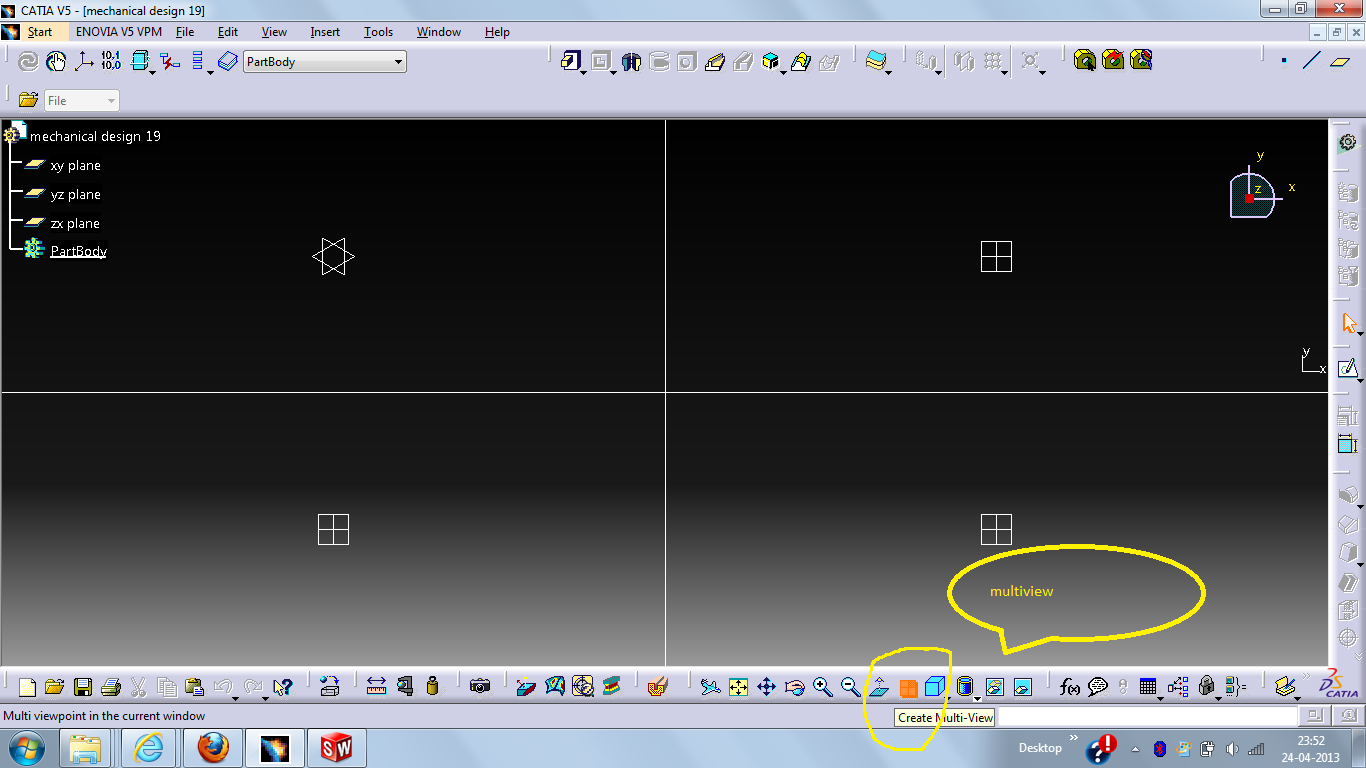

can't we rotate the two parts while assembling on same axis ??
By laxman on 24 Apr 18:04 2 answers 507 views 0 comments
i have to assemble a washer to a base figure
and to get all views i want to rotate them both but when i try to rotate i lose washer and have to find again by zoom out

    özgür kesebir over 4 years ago
    you can also use smart move. if you select the part before smart move command, it will open in a new window in same screen. then you can select anything easily and also u can constraint it in same new window.
