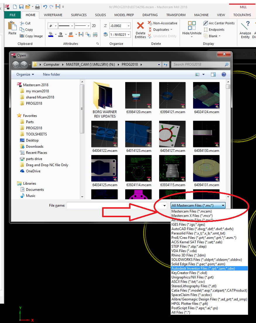

Mastercam can open many file types, although a few require a separate licence like pro-E. But you will find here that many engineers that create these models on GrabCad would be more than happy to save it in a file you need. Just have to ask. :)
also in my experience with mastercam, I prefer to request a STP format. most if not all Cad modeling software can export to STEP/STP. Best of Luck!

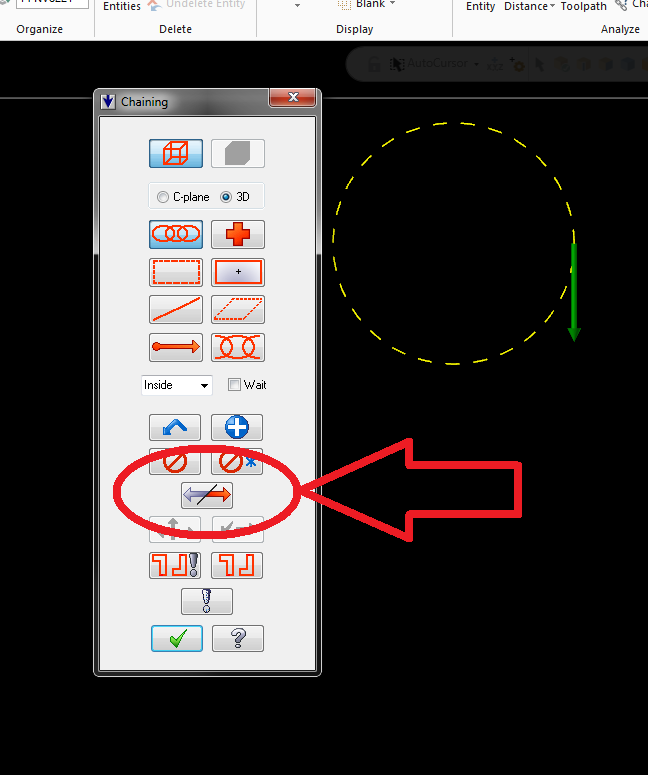

as far as Reversing your tool path when chaining. See the attached Image.
even if you have already chained it you can right click it and click "reverse chain".
