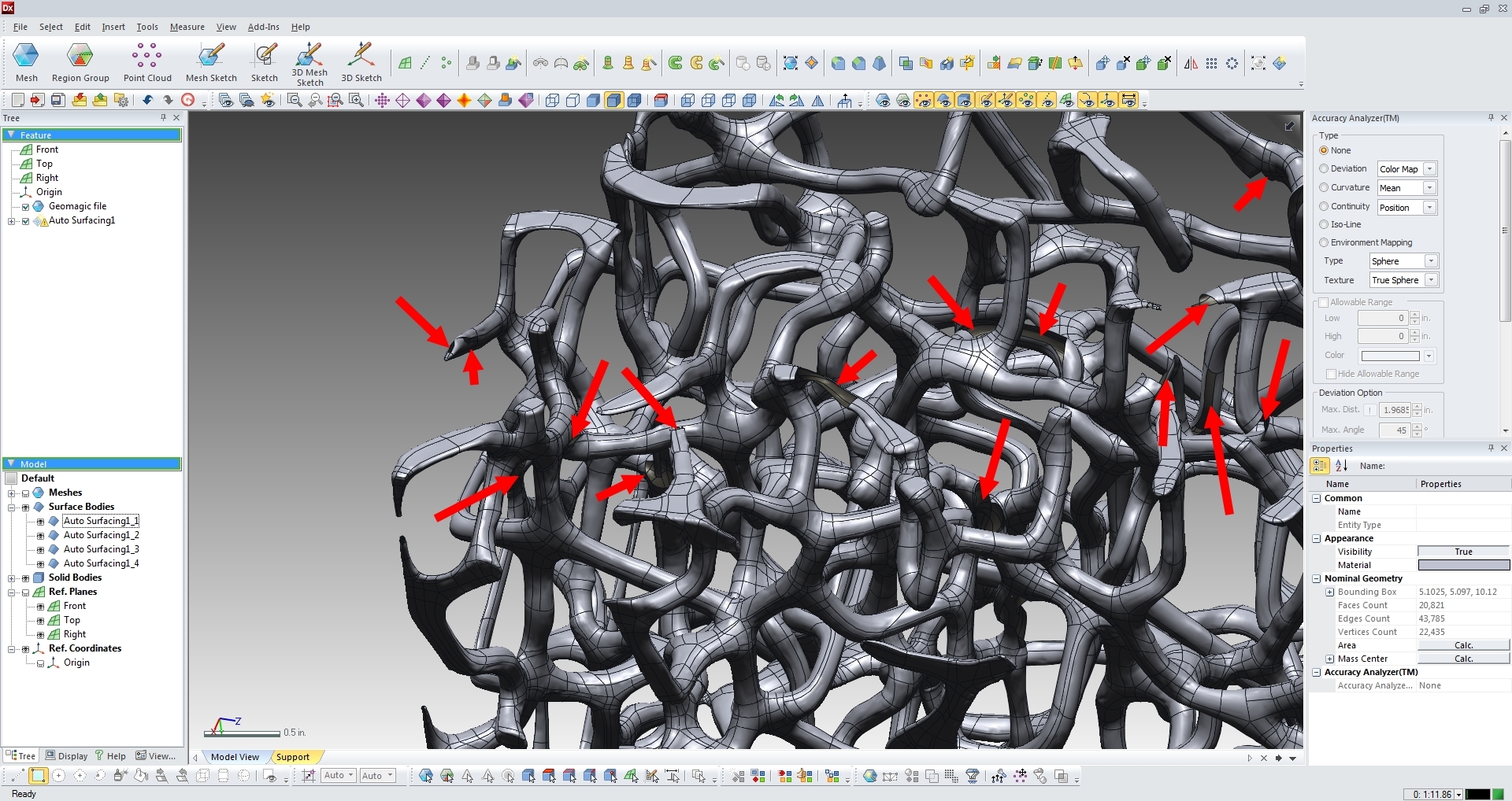

I've attached two screenshots.
The Design X image shows a number of gaps that it is unable to form a surface over. I've marked the locations with red arrows. If these were holes in an STL file they would be difficult to repair. Fixing these holes in a surface model is more difficult.

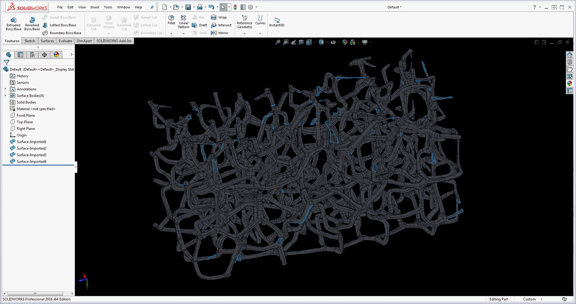

Exporting the Design X surface as an IGES file allows it to import into SolidWorks. Here each blue edge in the image is an open gap.
It may be possible to manually recreate many of the gaps with the surfacing tools, but it will be hours of effort.

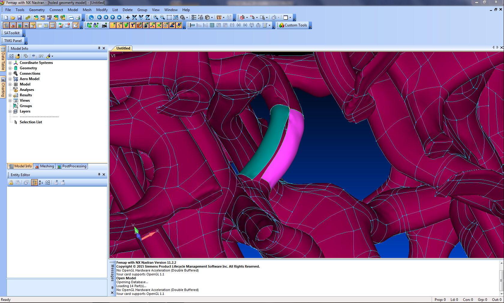

Well when I open the model in FEMAP, I see holes some part is missing. As you can see in the picture attached below. I already performed the FEA on STL file, but result is not what we were expecting, and secondly this is not the geometry. Therefore,I want to convert this file into geometry and perform FEA afterwards. The converted file you gave me was almost complete, just 8 or 9 spot are missing, rest the whole geometry is super awesome. If I am able to complete the geometry, my 80 % problem will be solved.
