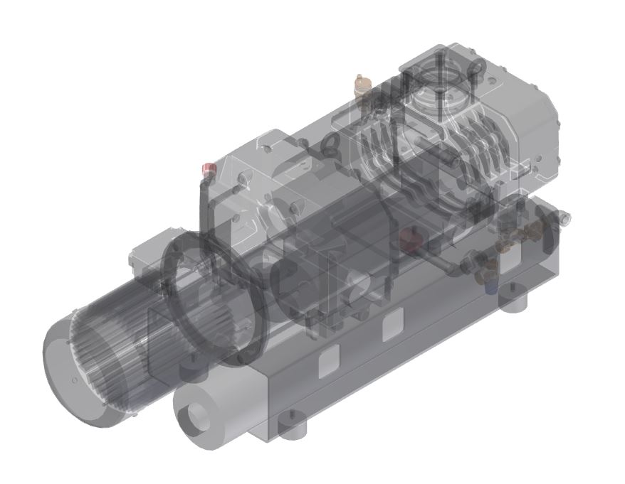

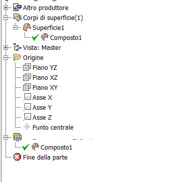

Convert file to Inventor Fede 23 Jul, 2018 12:56 PM I have this Step CAD file (attached), but the model looks like a surface body, is possibile convert in solid? Thanks Pump.JPG 2 Answer Fede Answered on 23 Jul, 2018 01:40 PM thanks to all, unfortunately I haven't solved, the sculpt command convert little part of ther entire model, and repairs body command dont works beacuse i dont have "real" body :-) Fede Answered on 24 Jul, 2018 07:56 AM Hi Jonathan, i attached that feature tree.JPG
