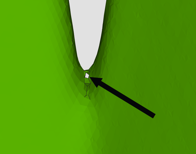

"Perfect scan data" might be a bit of a stretch. It is a good, clean scan, but the attached image shows one example of the triangles forming a void/bridge between two of the "fingers". It's not a big problem, but its a data error.

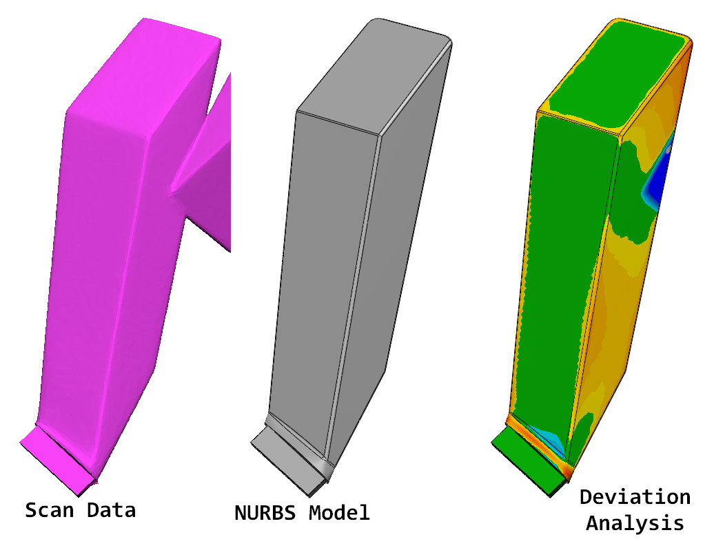

This model needs to be redrawn in a CAD program to get clean data for machining. I'll estimate it could take about 8-12 hours to create a CAD model.
If there are specific dimensions, or design considerations needed, those need to be discussed before a model is made.
A second screenshot shows the progression of scan data to a CAD model of one "finger" with a deviation analysis. The model is tricky to build, it's a big optical illusion of planar faces with perspective.
