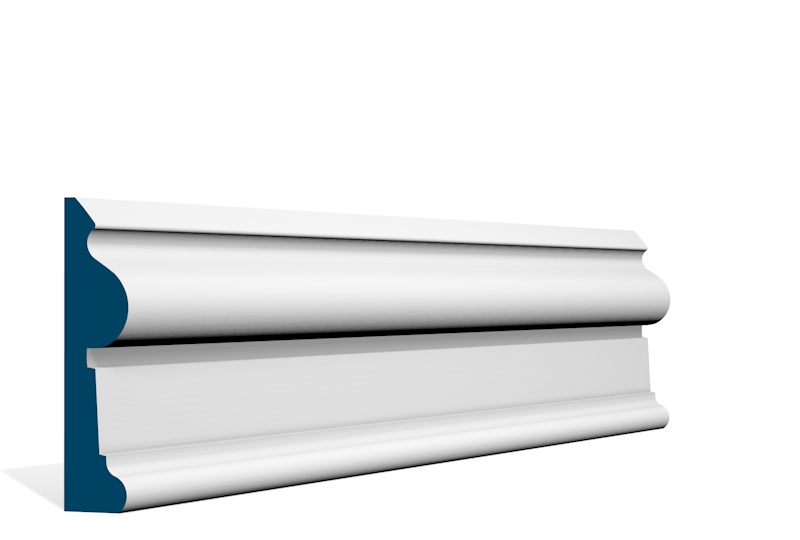

A 3D model is pretty easy to make, but can you identify in the image where the wall and floor are meant to be? To me it looks more like crown molding, but you mentioned it goes against the floor.
Ryan,
Hopefully some of the rendering professionals will also chime in, but a quick sample is attached.
A 3D step file of the profile is also here if anyone else wishes to render a scene, but not recreate the model.

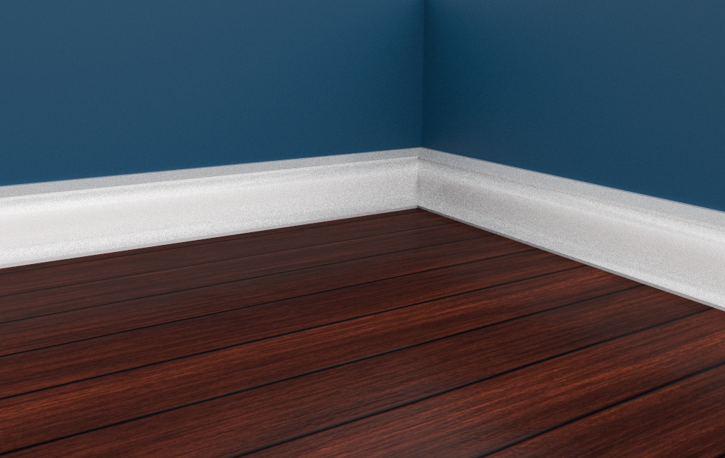

Hi Fred, Thanks for your reply. the image I attached is a coving image but it goes for all our cad drawing like Cladding, skirting, dado rails etc.
I have attached a drawing close to what we are after but I would also wish to show to profile against a textured background.
Thanks Fred, could you guide me in the direction of how to create this kind of thing from a cad drawing?
What program should I use?
