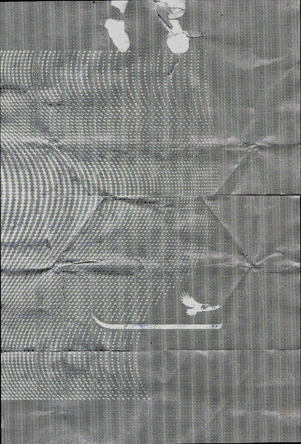

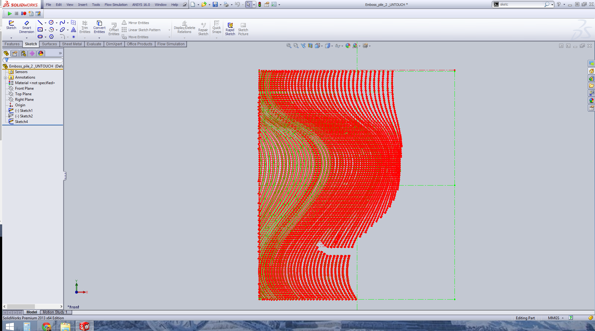

Hi! I have a job to recreate this beautiful pattern at SolidWorks 2013, but its very complicated and took me 2 days only to duplicate the curves. Now it's turn of the dots or more exactly rhombus, because it's more easy for production. So I wondering is it has some other program or method that will help me to recreate faster the pattern. My current method took me too many time and it's pain at the ass, too many lines for extrusion.

Answered with a tutorial: https://grabcad.com/tutorials/creation-of-complicated-dot-pattern
