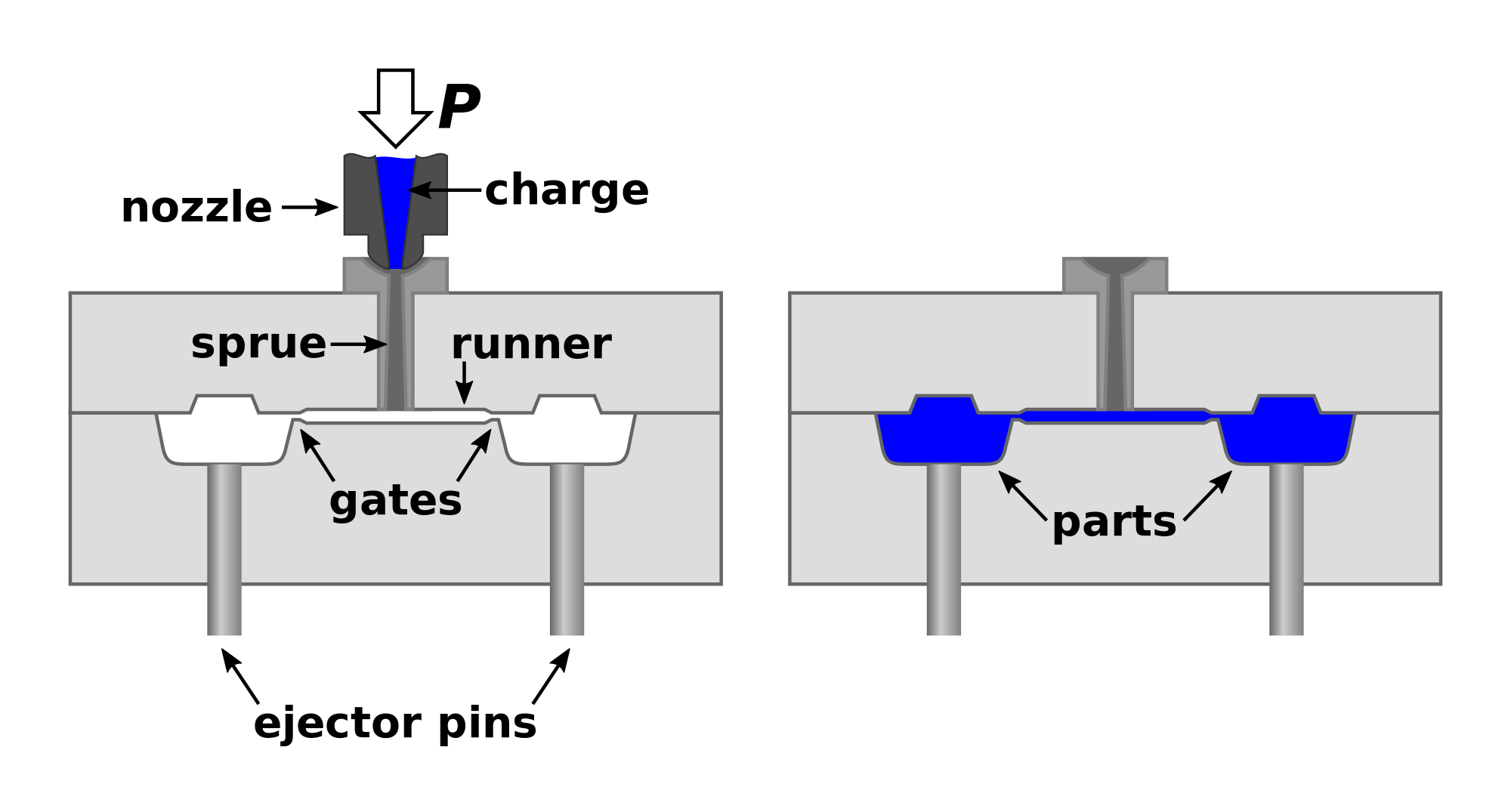

MAX MOLD OPEN & RUNNER - SPRURE.

3. Runner and Sprue are common vocabulary terms in the mold making industry. If you know nothing about mold making, it makes no sense to take the mold making exam. Otherwise, check online for a list of common vocabulary terms (http://apisolution.com/downloads/glossary_plastic_injection_molding_engineering_manufacturing.pdf)
Runner: In an injection mold, the feed channel, usually of circular cross section, which connects the sprue with the cavity gate. The term is also used for the plastic piece formed in this channel.
Sprue: The feed opening provided in injection molding between the nozzle and cavity or runner system.
Runner sprue and gates:
