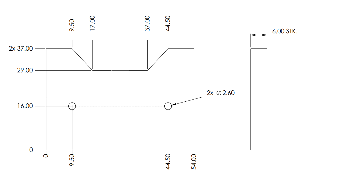

6.00 stk is an abbreviation 6mm thick material stock size
Yep, what lawrie said.
For sheet-metal parts, denoting "STK" or "STOCK" is pretty common practice.
If you go to throwing it on machined parts, you'd better be okay with mill stock flatness, straightness, etc.. Otherwise, tolerance and form need to be specified.
