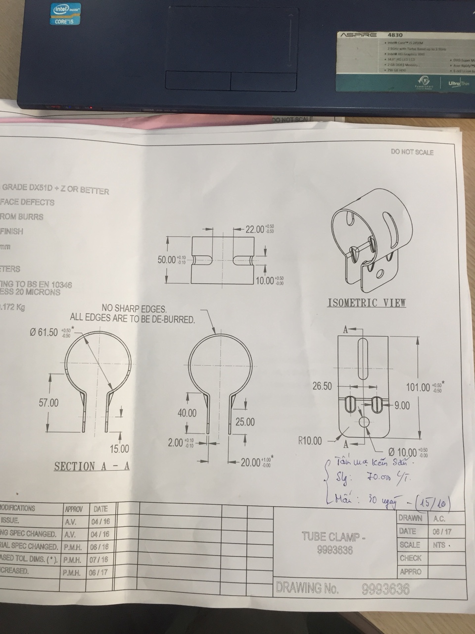

dear all
somboby please help me the way to make die stamping mold in this part

Design of dies is time consuming and requires many skills, that's why they charge alot, I don't think you will find it free. but if you try you will succeed, eventually.
You can make the die in consecutive operations:
- Perforate the sheet. (stamping / laser cut)
- cut the sheet (stamp sheer / laser cut)
- bend the sheet (specificially designed machine)
If you produce in huge quantities, then it worth and cost effective to make a die for punch/stamp press machine.
