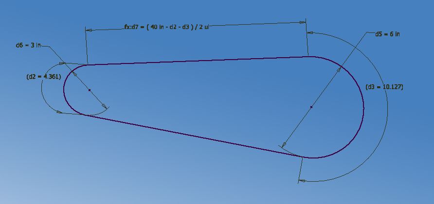

For a simple 2 sprockets and a chain arrangement, add arc length driven dimensions for the chain wrapped around each of the sprockets. Use these arc length dimensions in an equation for the straight sections of chain. Referring to my example for this simple chain arrangement. - Unfortunately adding in the variables required for the derailleur becomes too complex for Inventor to solve. You will have to manually adjust derailleur location constraints incrementally until the chain length is correct. I've modeled many chains and belts in Inventor and have found no better way to do this.
