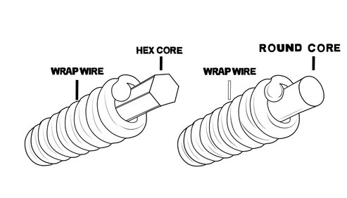

Do you want the string to be the same as the attached file?
If so, you'll need to use coil.
But a begin and end point for the string is kinda important.
Because you need to know the path of the string.
here´s a example
