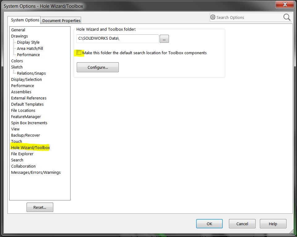

I found this: https://forum.solidworks.com/message/252202#252202
Maybe unchecking this fixes your issue. I've never used toolbox parts before, so this was "checked" by default in my SW.
