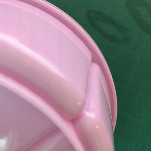

Having problem modeling this lunchbox :(
New to solidworks here.
I'm trying to model this lunch box here and I'm stuck!
As you can see in my file, I'm stuck trying to create the detail (pic 3.jpg) on the side and bottom part of the lunchbox.
I used cut loft (cut-loft1) to create the profile, but it doesn't work.
much appreciated.
