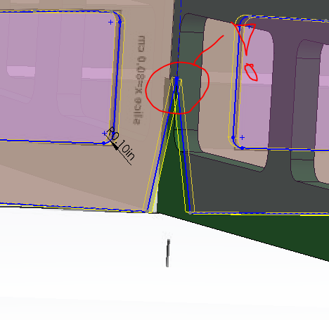

I have attached a part file and a drawing file of a hollow wood surfboard I am trying to model.
There seems to be a problem that I can't resolve when I am doing section views in drawing up a set of plans.
At Cross section "FF" in the drawing document I am unable to see the cutout properly in the rib at "Rib 6 Boss-Extrude" from the associated part document. That is the cutout where the rib is joined to the stringer at Rib6. All previous cross sections have worked but not past this point.
I have experimented with different shapes etc but can't get it to work.
Any help would be appreciated.
Duke
3 Answers
The Ribe has an incorrect sketch
That is why the ribs are not individual solid but connected together
Greetings Mike
Sketches should always be fully defined. all lines black
Hi, try it with the following part, sketches are all defined now
