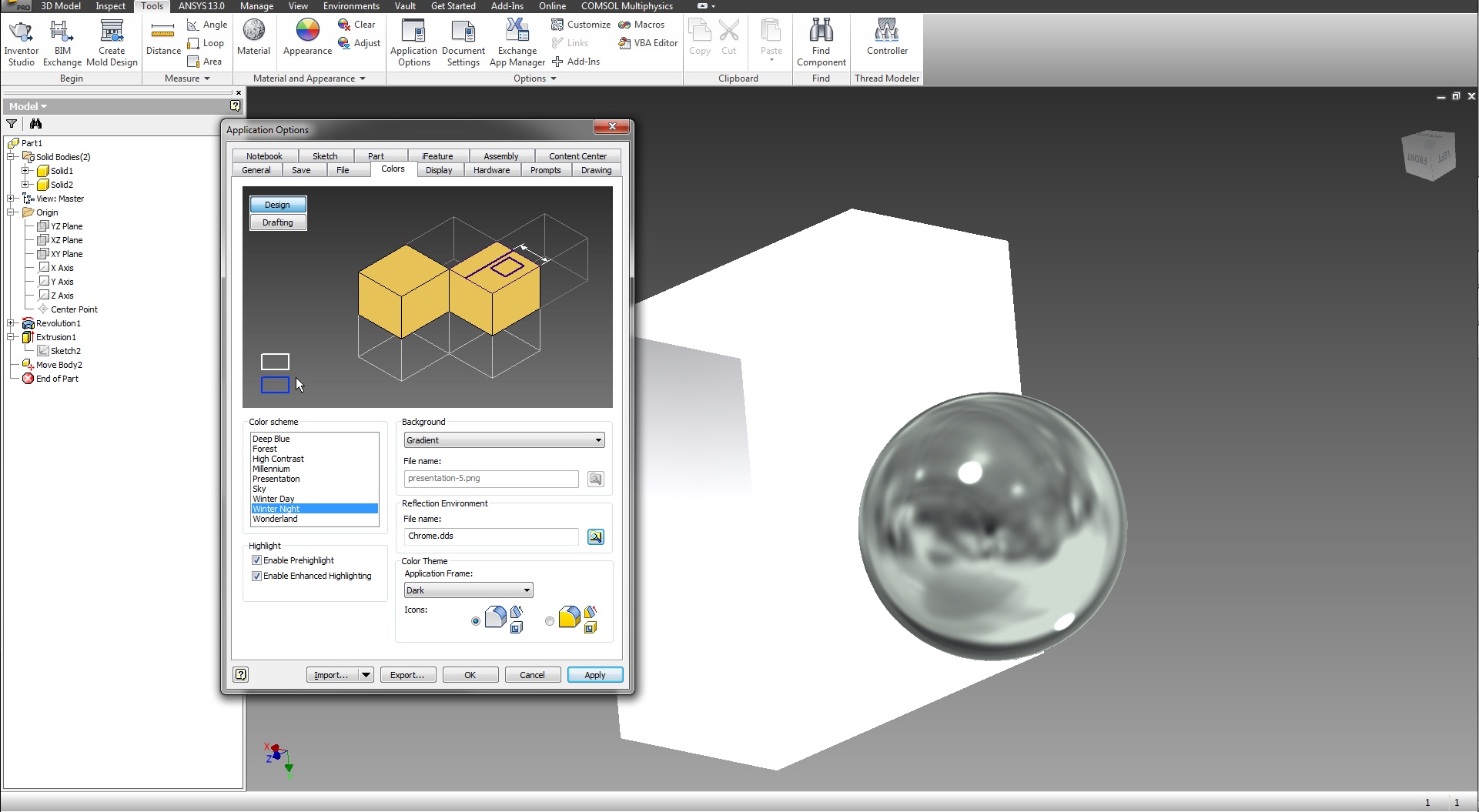

Hello there,
This should be an easy one just follow below...
Answered with a tutorial: https://grabcad.com/tutorials/how-can-i-change-reflection-image-to-other
Hello
What Inventor Youhave? My Inventor 2008 looks not similar , when i open Applications ---Colour__
I dont find settings table at all??
Could You sen dmore specific photos step by step
How can i make main setting sso, that i can see all those tables?

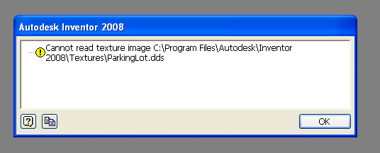

I try to do after orders, BUT its not work, I m misisng all reflection image, comes info that Inventor dont find path to
I have close and open according orders, but problem is inside;
Must i open DDS file, where image is or wich way it can change?
If i only rename other image to ParkLot, its not wor
Must i maby open some pathts for Programm etc??

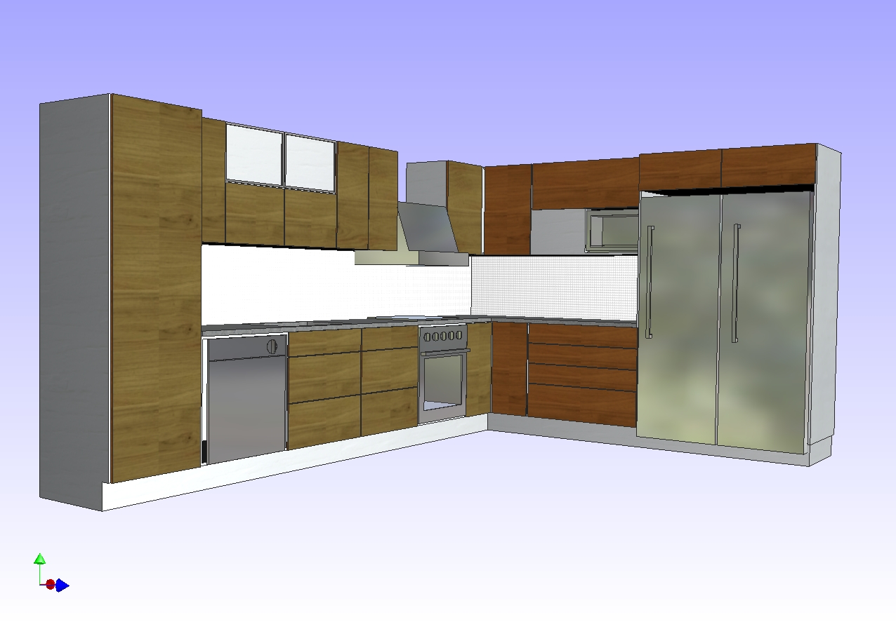

Inventor student from Finland
PS; See my kitchen render
