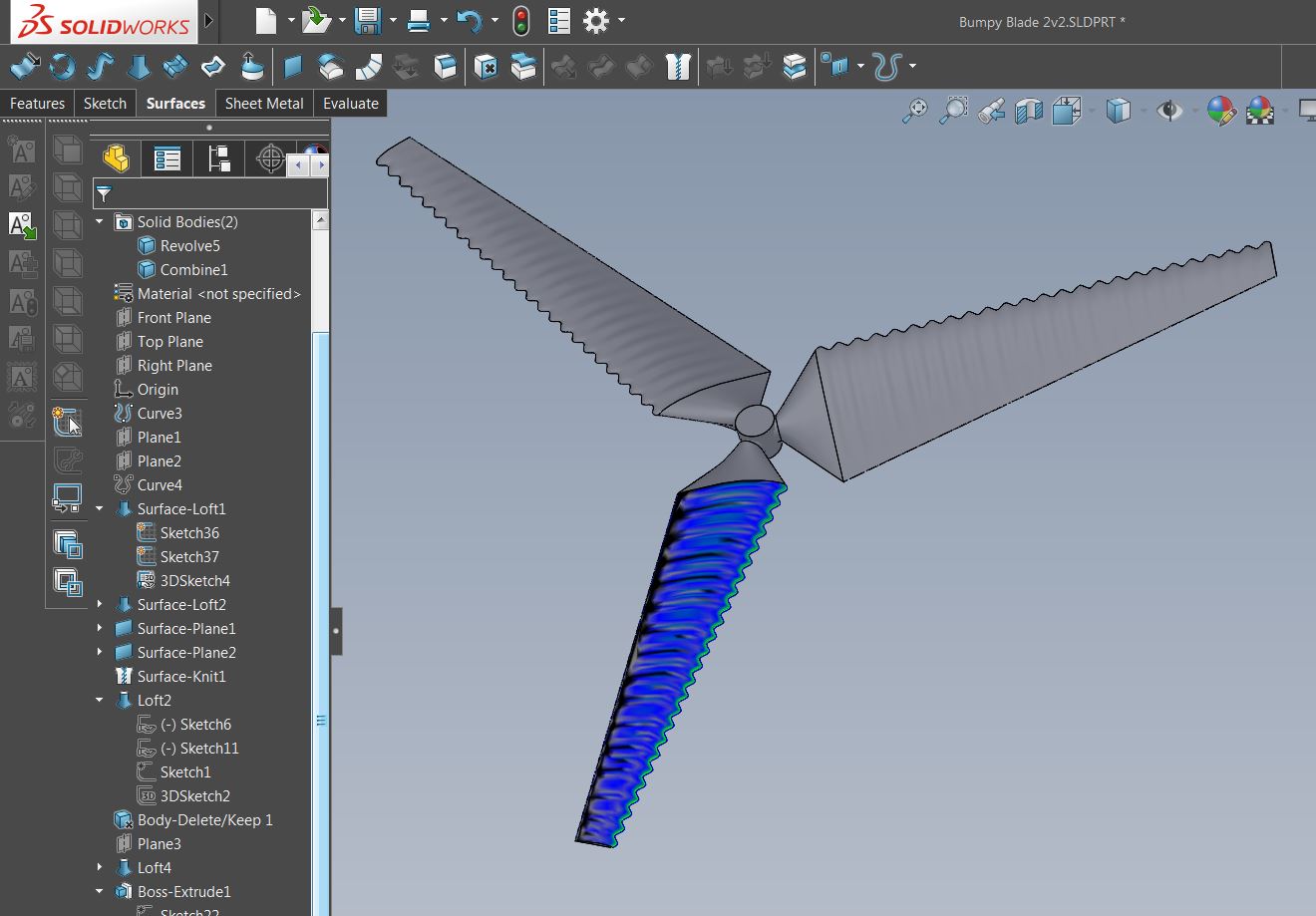

The attached model has the suggestion I made previously, which was splitting the airfoil section into a top and bottom surface.
This helped the trailing edge weirdness that was going on but whether or not it solves your mesh issues, no guarantees.

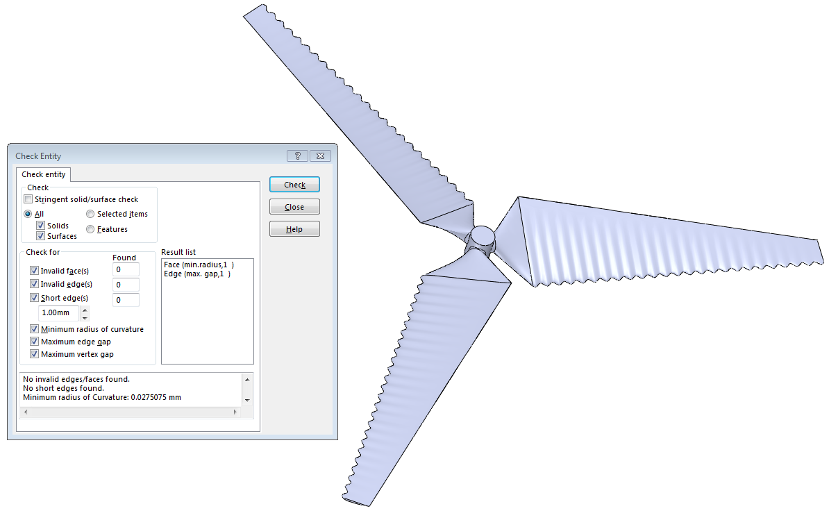

Tools - Evaluate - Check
Is one place to start, but it really depends on what you are looking for.
This model does not have errors detected, but the cool wavy edge of the blade is a "knife edge" with essentially no thickness. Given the size of this model, I could imagine that edge being more like an inch thick in real life.
