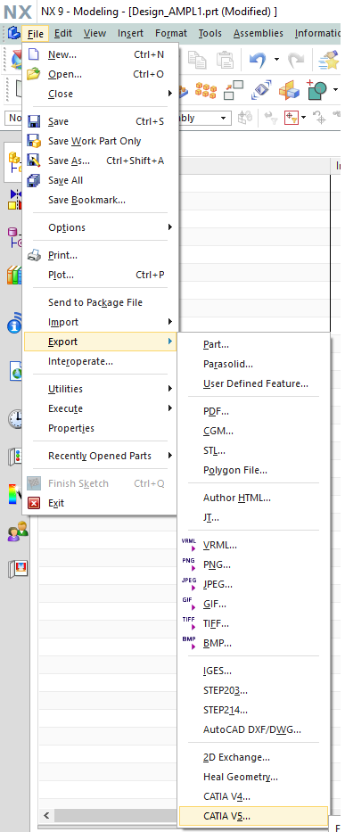

how can i convert prt data inti catia v5 data Bilal oztas 5 Oct, 2017 04:51 AM ı need help about nx (prt) data convert to catia (catpart) data. i already have NX10. 2 Answers Dinesh Kumar Answered on 28 Oct, 2017 10:27 AM Just export the file to VATIA V4/V5 Format. Refer Image attached. Untitled.png Jack K Answered on 5 Oct, 2017 01:07 PM save the NX part as a STEP file, and then open and save it with CATIA
