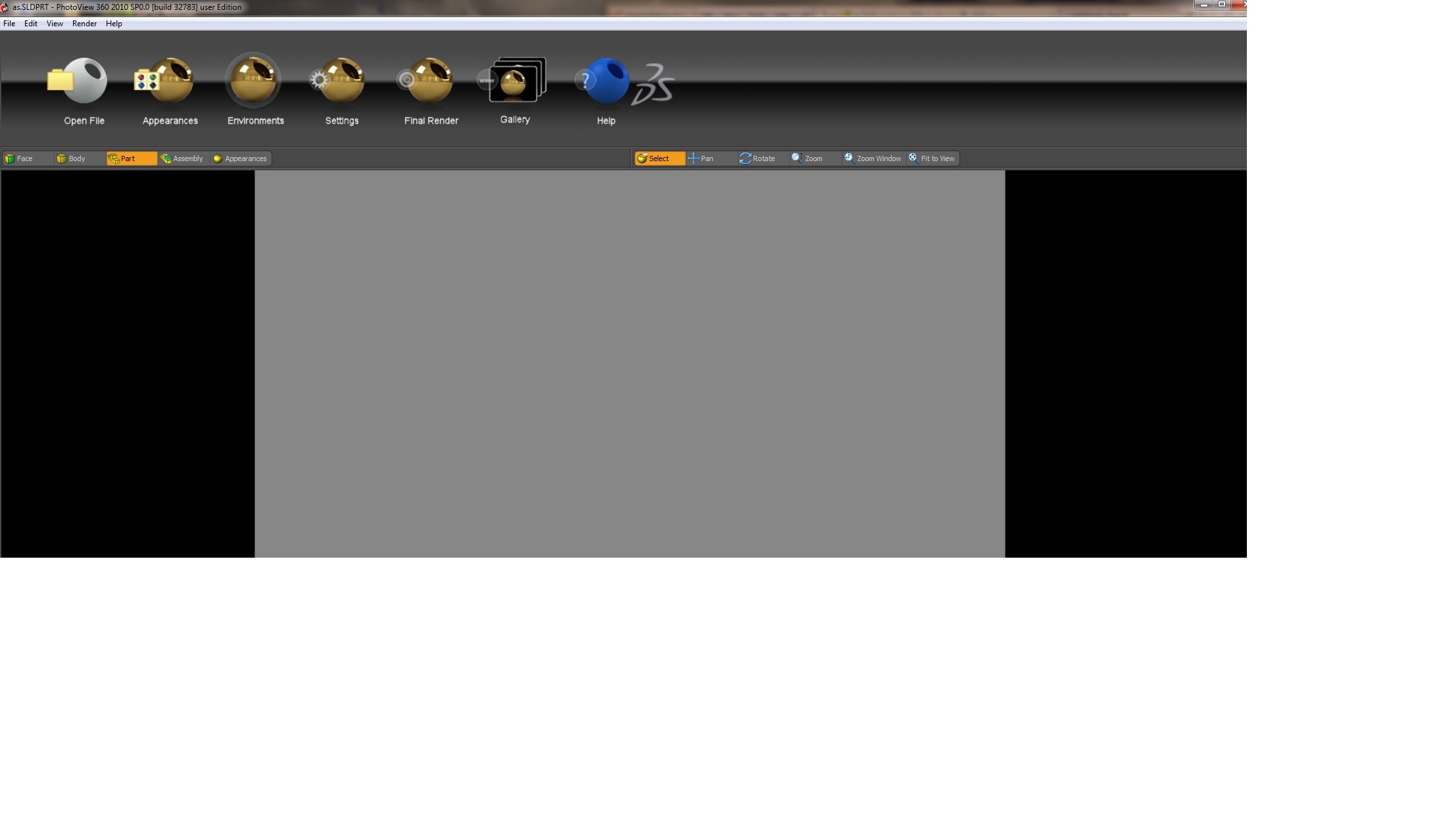

HI
I have a problem in photoview 360. I don't see my cad part in this window.
what can I do in this situation?
I want to mention that file was .stl. After that I save in SW2010.SLDPRT.
Next step I open photoview 360 and I tried to open this SW part and nothing...
A make a verification and I created a simple cad part in SW and this file has gone open in photoview....
I remember that older version of PV360 or was it photoworks that surfaces were ignored and it would only render solids. try creating a simple cube in the same file as the ST import and see if that renders, if so you then need either convert the stl into a solid file.
I vaguely remember an option to render surfaces or not but can't find that in the SW 2012 that I have installed.
