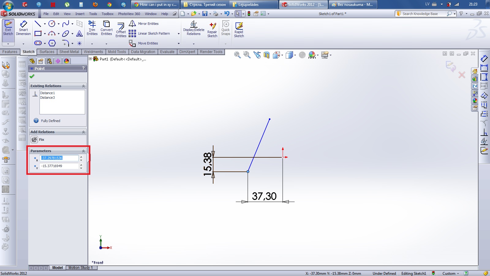

How can i put in xy coordinates ,example by a line ?
When i draw a line in my sketch ,there is only a field for the lengh !
How can a get in any x and y positions ?
thanks , for your help !
2 Answers
Select endpoint of the line and in property manager you can see x and y coordinates, or you can just give it a dimension from origin.
Try drawing 3D sketch instead of 2D
