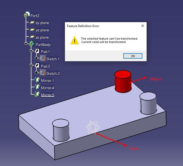

How can I re-mirror an object mirrored?
I want to re-mirror an object I previously mirrored with another plane in catia v5, for which I get an error. please guide me. thank you
I'm not sure why, but CATIA V5 doesn't like to re-mirror features that are mirrored.
There are usually better methods that could be used instead of Mirror-Mirror-Mirror. In the case of the example in the attached picture, a Rectangular Pattern is a better way to copy the first cylinder.
Don't use the mirror command again and again. There is one feature called "pattern" use a rectangular pattern to make the design. You have to select the direction as well as change the direction using a second space and provide a dimension between the objects and the number of instances.
