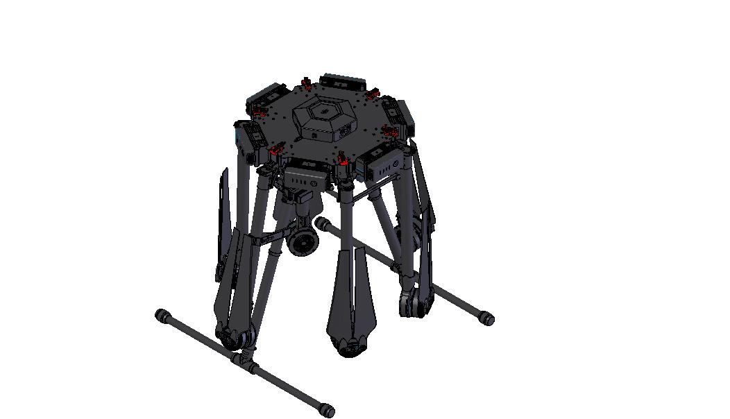

I need to print a 3D part and this part need to be a negative form of an assembly (M600 PRO Drone image attached). I'm tried to do this using the combine tool from Solidworks 2017.
My question is how can I save an assembly as a part to use the combine tool? The part needs to appear like a solid body and I can't get this result.

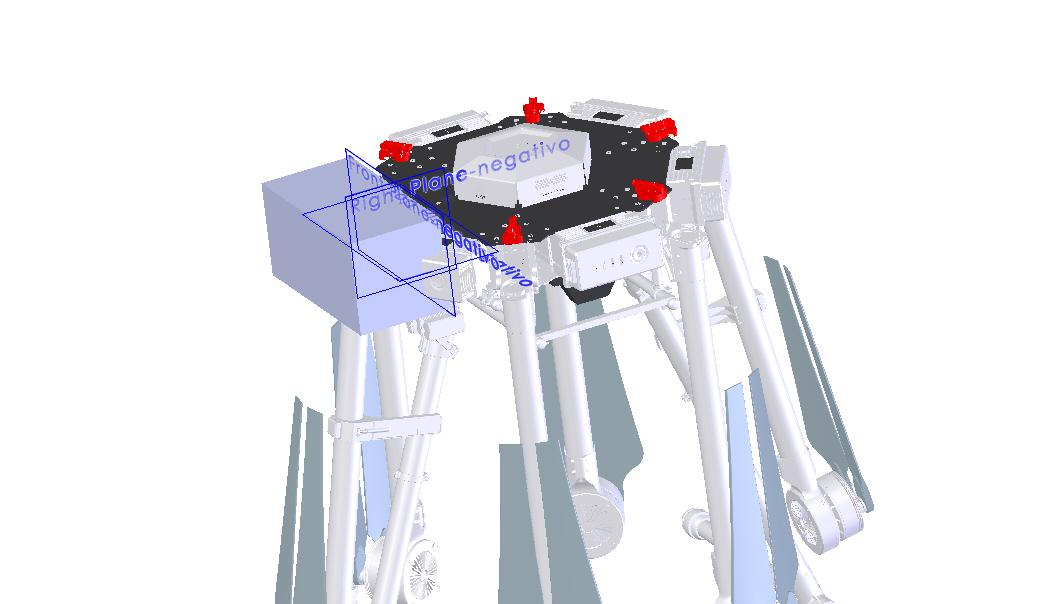

There are two pictures attached to show how I need the negative form.
