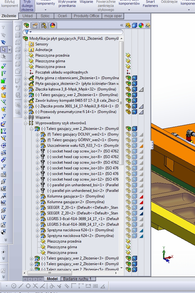

How can I see the total quantity of parts used in my assembly in SolidWorks?
I have got lagre assy with many sub assemblies and do not know how many parts it contains....

I'm afraid that I wrote my question in wrong way.
I mean i have assembly with meny subassemblies (with screws mirrors of it and patterns of parts).
I do not wanna to count them all in the main assembly tree by cliking on the + in the each subassembly and its mirrors and patterns operations.... it takes long time and i will make mistake for sure.
I thought that there is some option to do that....
