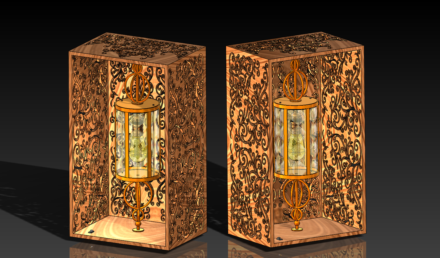

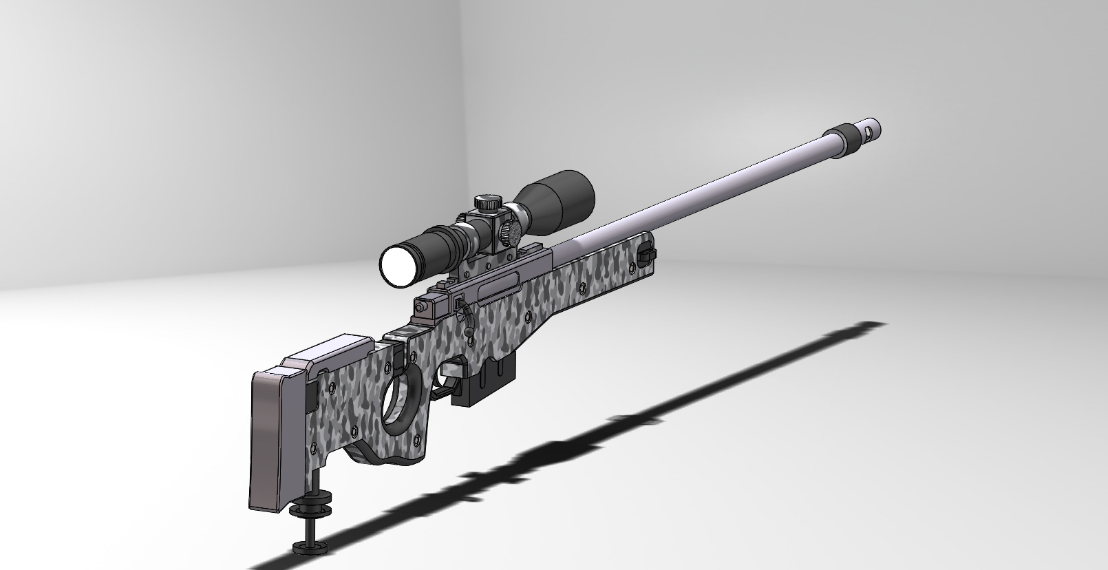

Example I leave you two render that I made with different video cards not certified by solidworks, but with these tutorials activate the graphics real view, and works perfectly.
SUCCESS!!!
