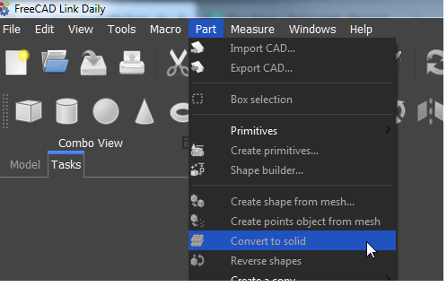

Hello, You can convert stl to step in Solidworks if it have "3d scan" addins but it is very time and resources consumer. The best way is with Freecad in "Part" workbench you will have "convert to solid". After conversion "refine" and export to STEP.
