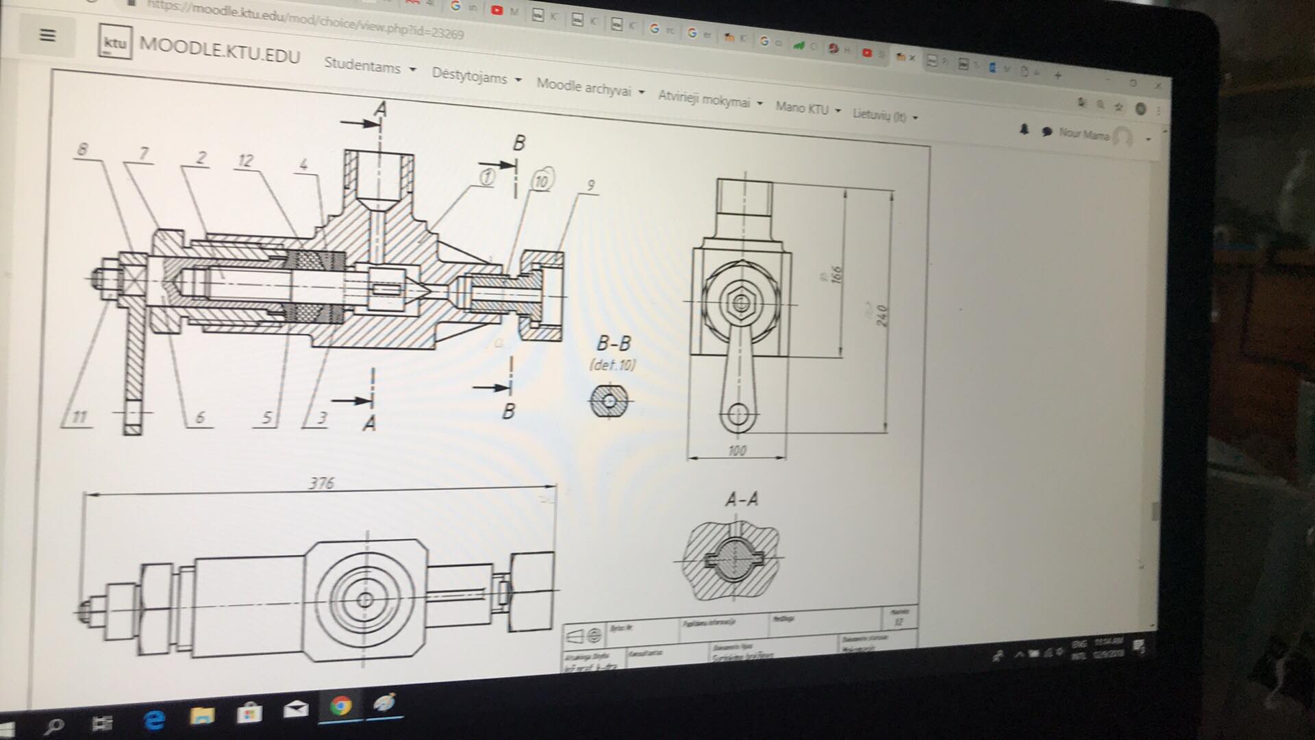

Hello guys,
can someone please help me in drawing this on inventor ?
thank you

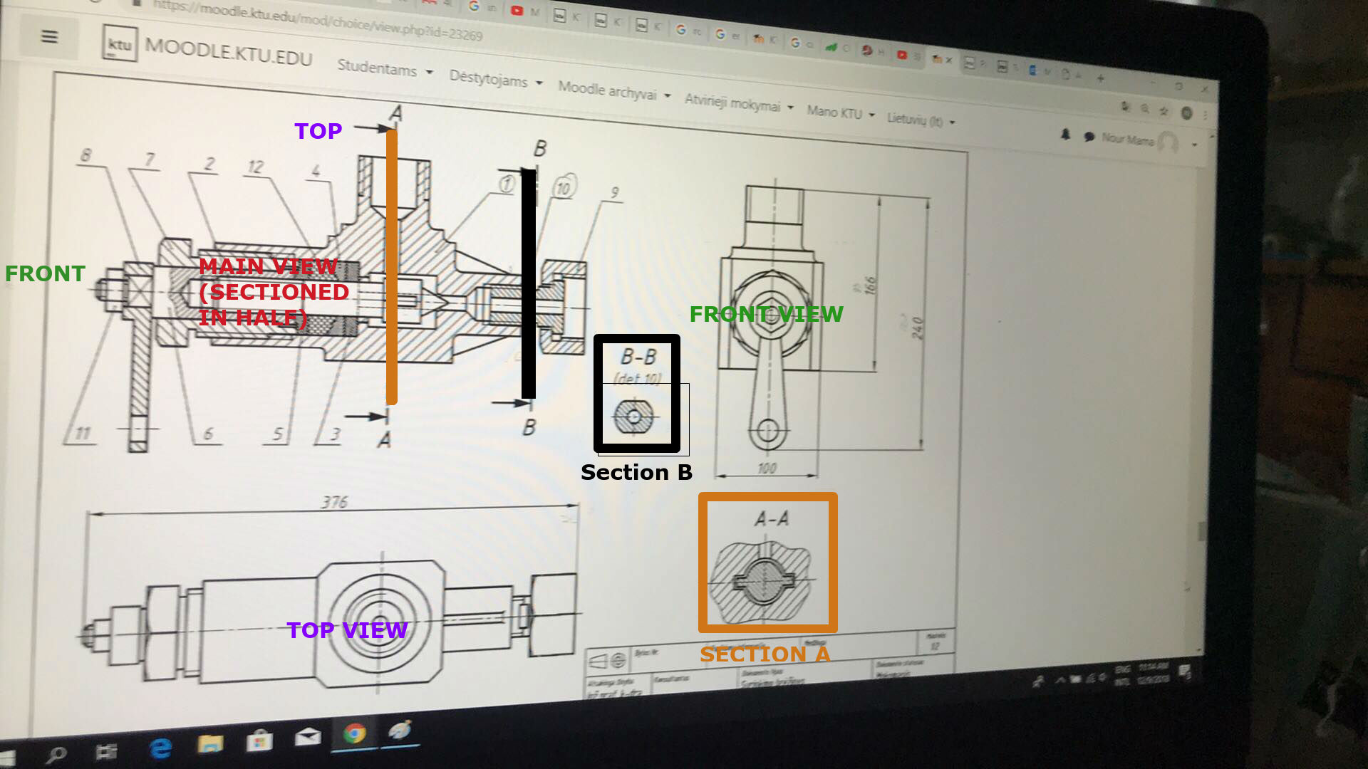

Hello, I made a reference to help interpret the drawing. It's an orthographic drawing with a front, side, and top view. There are also a few section views, which are like a slice of the part so the inside can be seen. For making this on inventor, I'd start by making the base of the part and then do the cuts on the inside. Don't forget to use planes as needed. Hope I can help!
