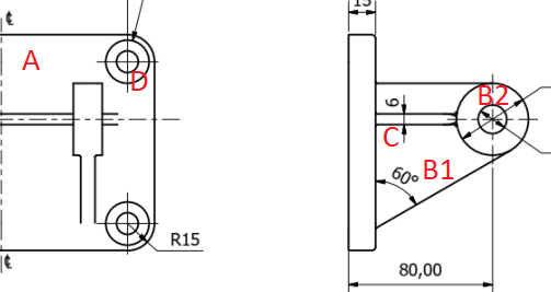

How do I draw this bracket in different methods
3 Answers

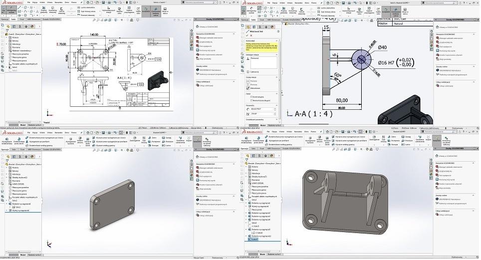

A strategy:
*Take advantage of symmetry to draw half a piece
*Sketch and extrude the base "A"
*Sketch and support "B": extrude "B1" and "B2"
*Sketch and extrude rib "C"
*Sketch "D" bore (can be done manually or with the drilling utility)
*Do mirror operation
If you have a dwg dxf drawing use it to draw a sketch.
If you only have this drawing, insert the picture of the drawing into the sketch and draw on it.
Pulling out the base.
