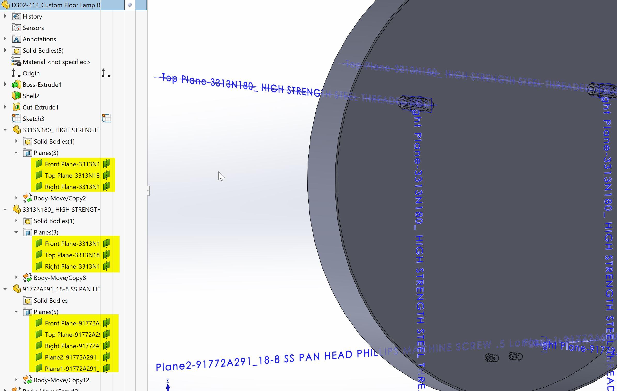

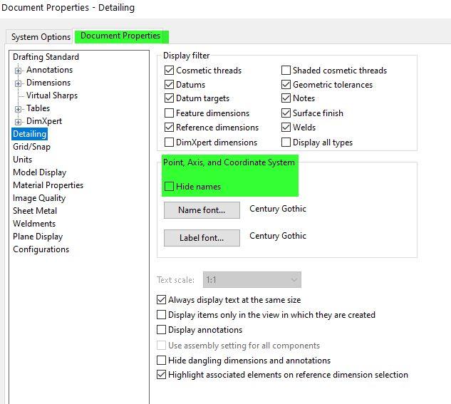

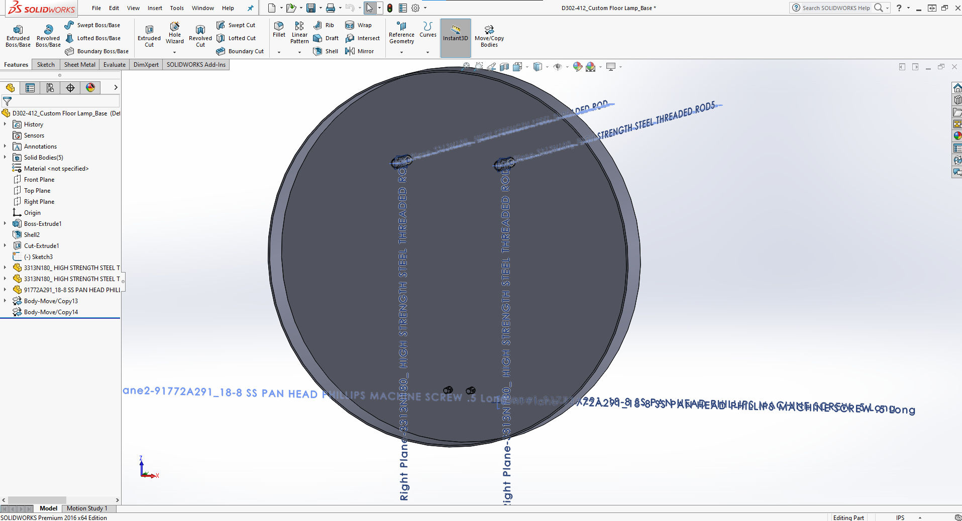

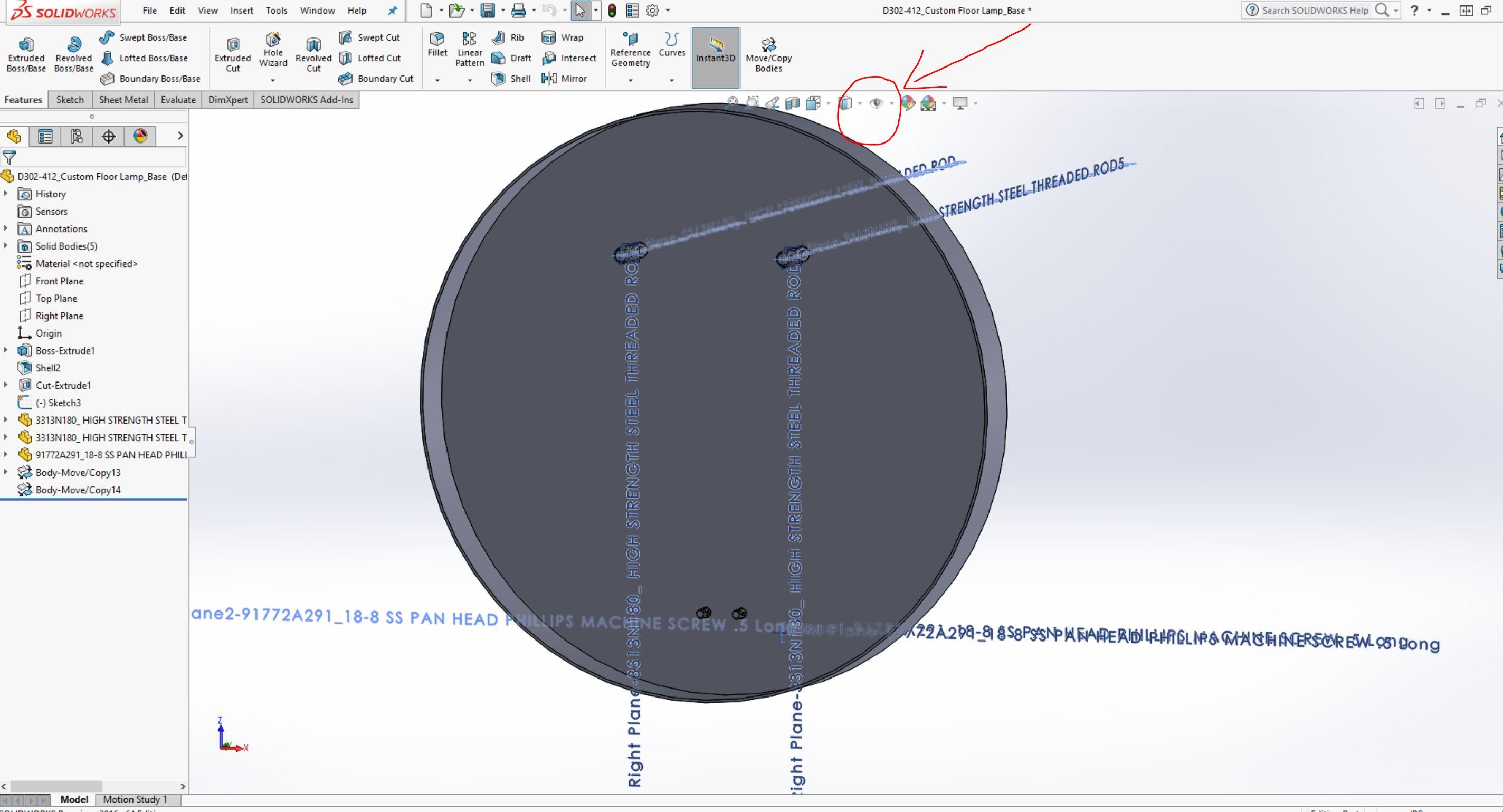

How do I hide the text in the attached file? Jason Yost 15 Mar, 2021 03:17 PM I am using SW 2016. I inserted the parts into my part drawing and they came from McMaster's website. Light Base.png Accepted answer SolidTweaks Answered on 16 Mar, 2021 08:50 AM Did you try this? 111.jpg 123.jpg 2 Other answers MF Answered on 15 Mar, 2021 05:02 PM Try to click on the EYE symbol in the center of the screen and see if you can toggle them on/off. It is located on the "Heads-up view toolbar" (View > Toolbars > View (Heads-Up)) Capture.JPG Jason Yost Answered on 16 Mar, 2021 02:30 PM See file D302-412_Custom Floor Lamp Base.SLDPRT
