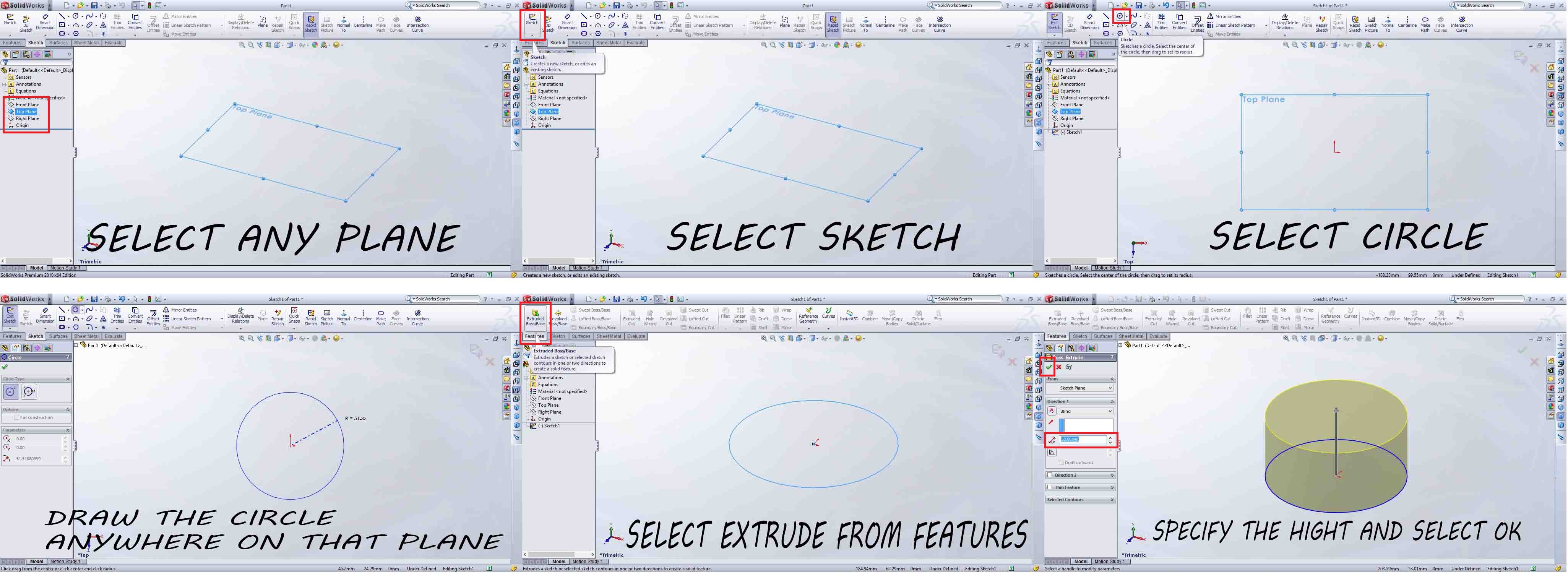

Noushin Rahija Huma
Answered on 4 Jul, 2015 10:00 AM
select a plan,draw a circle & then extrude it.....after that can filet the edge......
or,
it can be revolved supporting an axis...................
Comments 0
