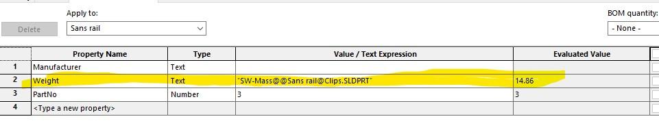

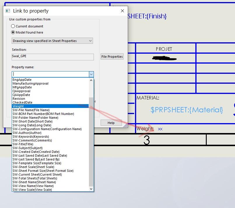

I can't get the configuration specific property with "SW-Mass" to wotk with drawing template.
The weight reported is the same wathever the configuration drag into the drawing template.
SW-Mass1.jpg is from the drawing template, SW-Mass.jpg is from the custom property of the part.
Any idea?
Thanks

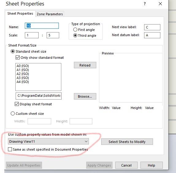

So far, the only workaround I found is to tell for each sheet to used custom property from model specifi view and not from the default one.
Than's very annoying as the property aithin template are to gain time and not to loose time.
If somebody find a way to get it working as it should work thanks to let us know.
