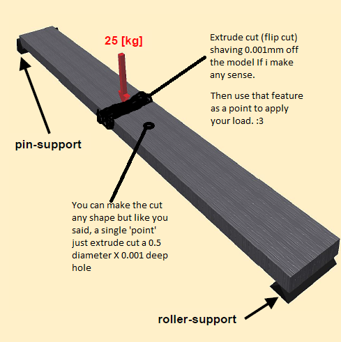

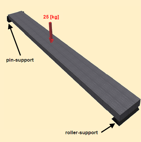

how do i apply a single point load on a beam on solidworks
Can you upload a picture so I see what you mean? Or better yet mark up a print creen and scan/upload it for clarity. I'd be glad to help :3
Thanks. its a 300X30X6 beam. and i want to place a single point load at the centre of the beam on the top plane.
Thanks a lot!!!
saved me from a stressful weekend :)
You're welcome buddy! (^^,)
