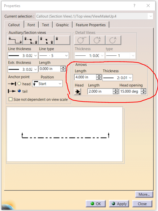

How to change arrow size of "offset section view" tool in catia drafting? hoso okhovat 7 Apr, 2021 09:18 AM When we reduce the scale of the shape, the size of the arrow becomes very small. Also, by right-clicking on the arrow and selecting the properties, then selecting the "size not dependent on view scale", the size of the arrow becomes much larger. 2 Answer Muralitharan P Answered on 8 Apr, 2021 04:59 AM see this video 2021-04-08-10-25-48.mp4 Jack K Answered on 8 Apr, 2021 03:22 PM just like the video that Muralitharan linked to section arrow.PNG
