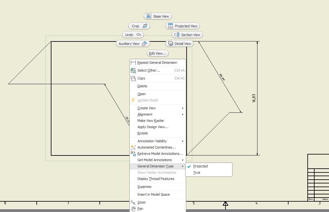

How to change the main UCS align to edges of part model?
I attached a part that is not according to ucs and it cause to not measure corrected in 2D drawing.it shows in attached drawing file.
I used the UCS command but that make a new UCS and it not resolve my problem.
Change the drawing views to projected dimension type.
Right click on the view.
Select "General Dimension Type"
Select "Projected"
