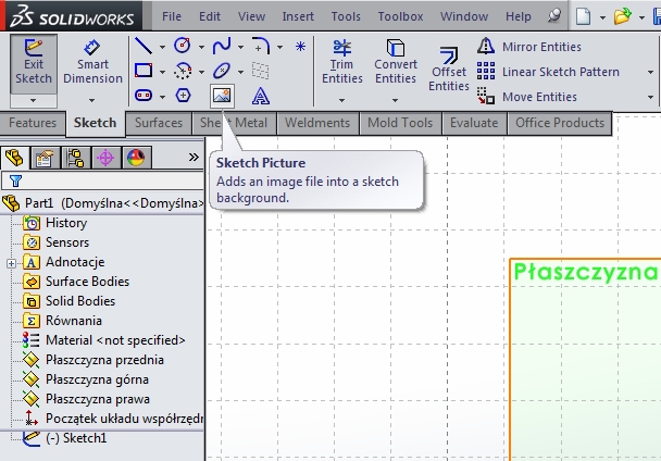

Open a sketch on the plane, insert "Sketch picture". Then you must scale your pictrure and add new picture on the another plane.
If you have this, Now you have to use a line or spline to trace the outline. This is the same method used to create the car body.

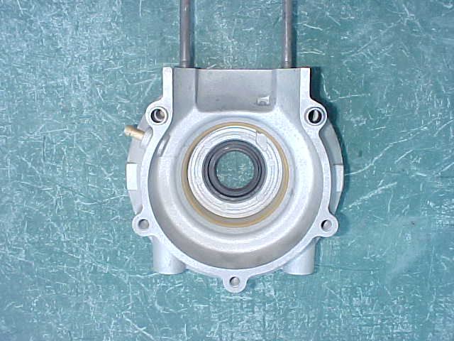

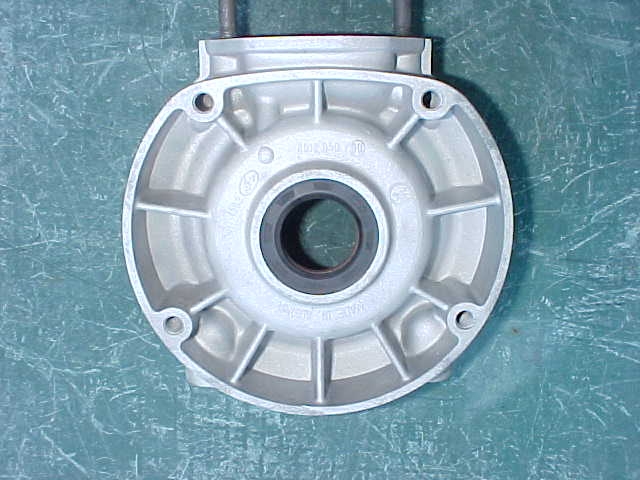

Can a Cad file be created from a photo like this? The PTO Side (4) Bolt Holes are 8mm.
What about the same question in CATIA V5...what is the method?
I think, you can't "convert" direct to have fully "converted" image. You can use your picture as the base to modeling it what Lukasz Siwiec said. J.J. has half - method.
In CATIA V5, you can not convert directly like SolidWorks.
