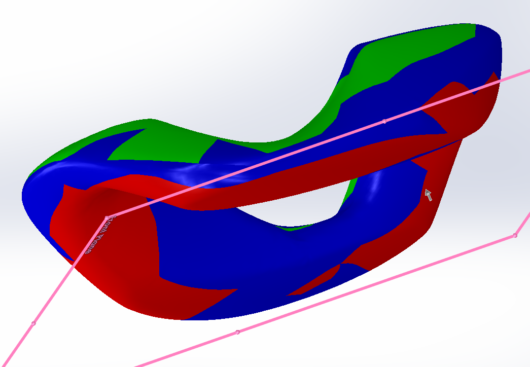

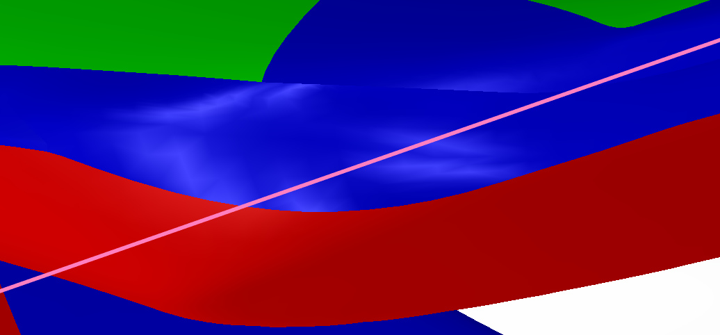

The first this you may want to try is adding split lines to clearly define a parting line. Numerous faces appear to straddle a possible parting line. Another possible issue is that there seems to be an undercut or pocket on one of the surface that would require a side action to allow the part to be removed from the mold. This face may need to be modified to allow removal from the mold without adding side action tooling.
Green surfaces have positive draft, red have negative draft, and blue straddle the parting line having both positive and negative draft.

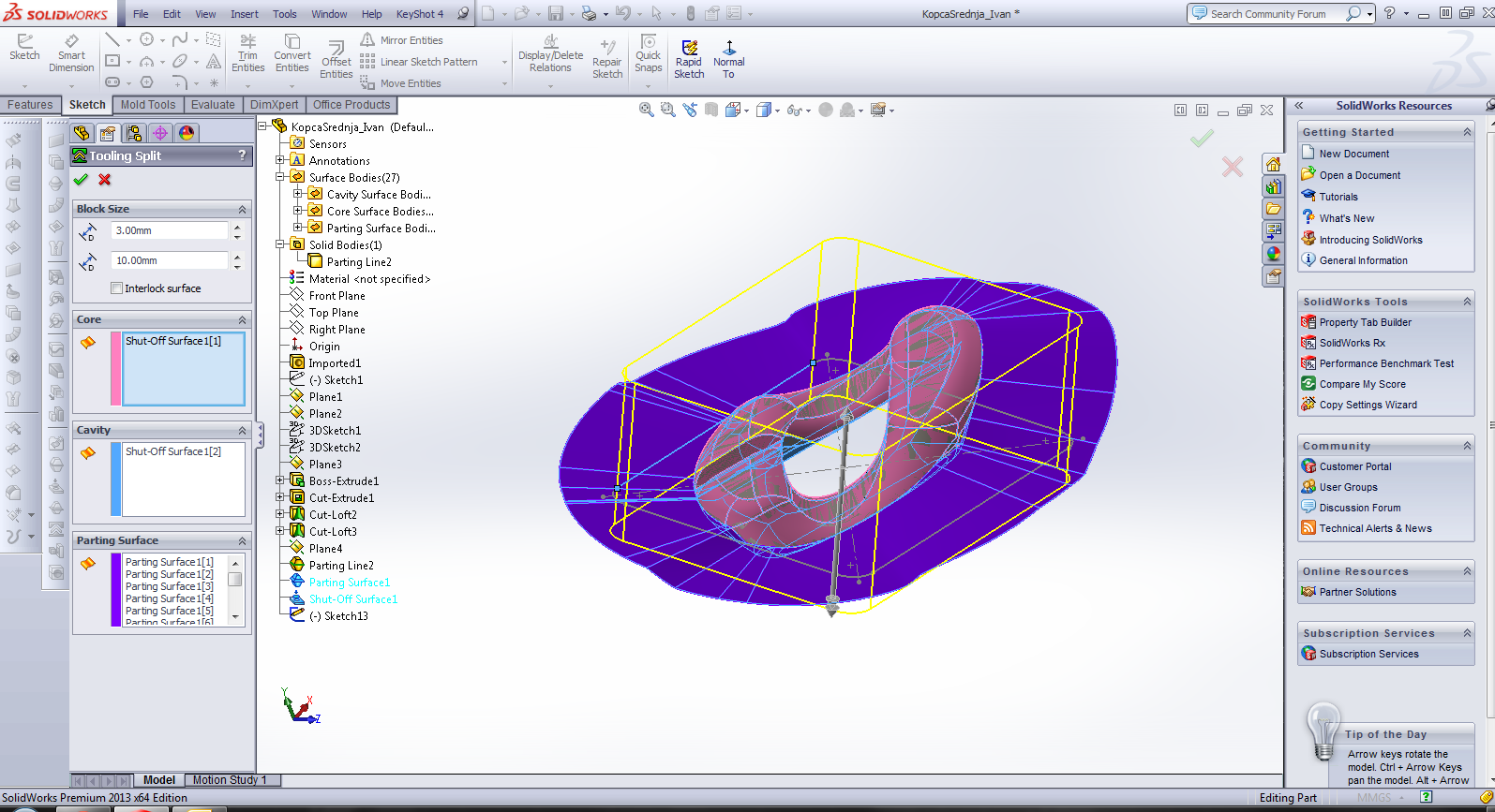

Part with parting surface, but I can't make tooling split
Now I have better part! Please help
Does anyone have any idea?

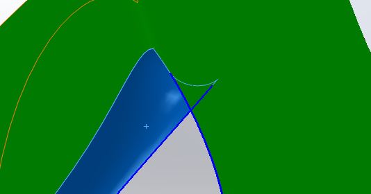

The parting line for the inner opening needs to be better defined. There is an undercut that is preventing a clean parting line from being created by the software. The ends of the curve for the inner parting line don't meet without passing over the surface of the undercut. See the attached image. The surface highlighted in blue shows the undercut on the upper right side of the inner opening.
