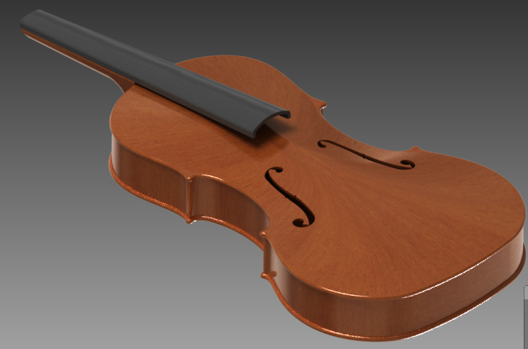

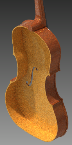

The scroll is the very tip of the viola (The first picture). The last two are what I have done so far. Any help would be great. Thank you!
The only thing I can think of doing is just leaving that basically one big chunk and carving it by hand, but that's because I am thinking like a machinist. I'm sorry, I don't know how to model that :( Maybe you can play around with the "Coil" function and see if it can taper, but I have no other ideas. Maybe you can just make a flat shape and then just use the spline function and make a spiral. From there, you can give the spline some thickness and cut in via extrusion, then chamfer it so it has a cinnamon roll sort of look to it.
I wish I knew how to do that! Now I have something to learn! Once I figure it out, I'll tell you how to do it!
