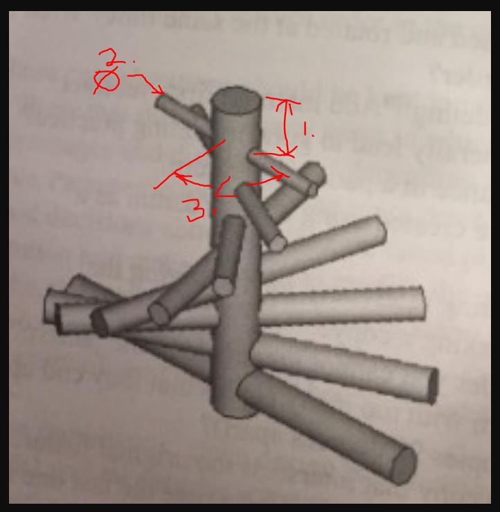

How to create this part using PATTERNS
2 Answers
If it still works like back when I was using Pro-E, it's pretty easy as it allows you to select multiple dimensions to use to drive a pattern. Your example would use 1)the dimension locating the peg vertically on the cylinder, 2)the diameter of the peg, and 3)the tricky one, you'll need to make sure there's an angular locating dimension to the peg.
