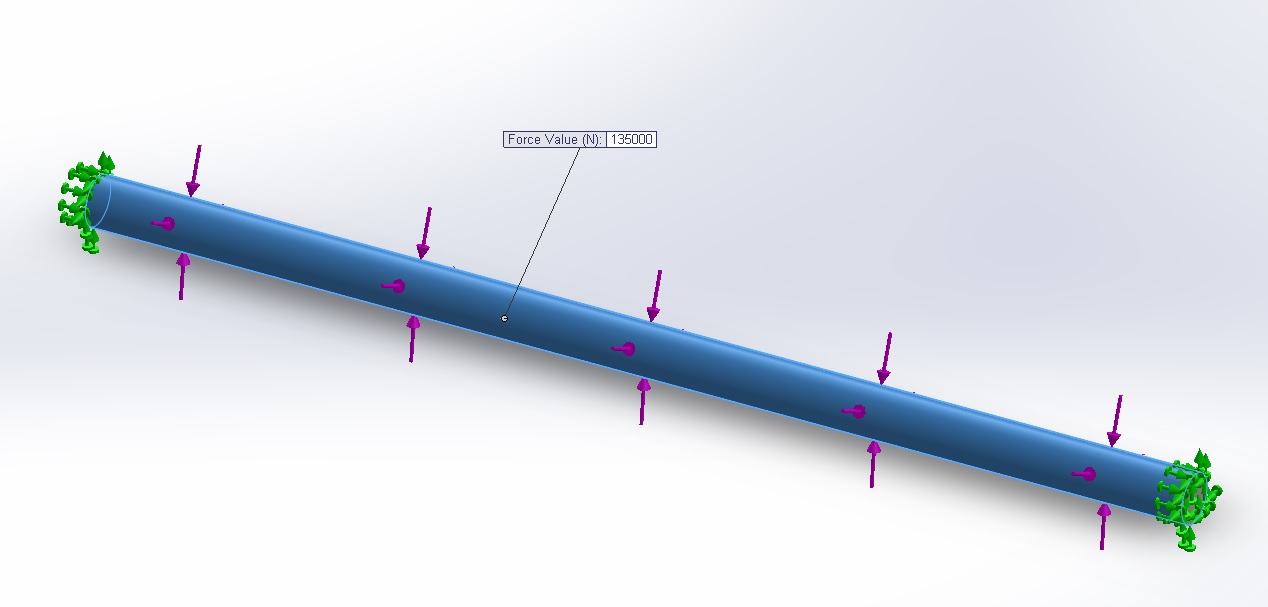

Hello, I have a part that I need to to static force/load analysis. It is full material tube diameter 30mm with a length 680 and material S355, static/force load in one way should be 135kN into the center. Fixtures are at the end of the both sides, let`s say about 10mm from the both ends.
Create sketch, reference geometry and use spit lines. Than you will be have one solid model but 3 faces and you can be able to set into the center.
