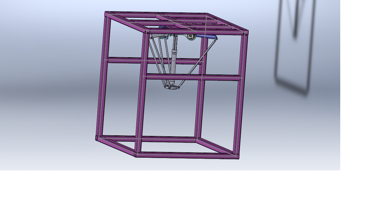

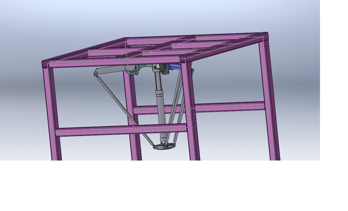

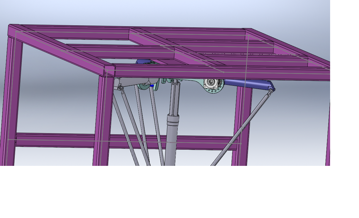

Hullo to everybody.
My question regard a simulation problem.......I have a robot(autonox 24)on the top of a welded structure, I started a motion simulation giving a motion low to the tree motors. motion simulate correctelly the robot movement.Now I would like to know if the tube tructure that support the robot can resist to the vibration caused by the robot continues motion..Is there a way to export the forces into a new simulation dynamic study in order to see the behaviour of the structure during the opereting tange of the robot?
thanks in advances to everybody
Drag and drop to the new study.
