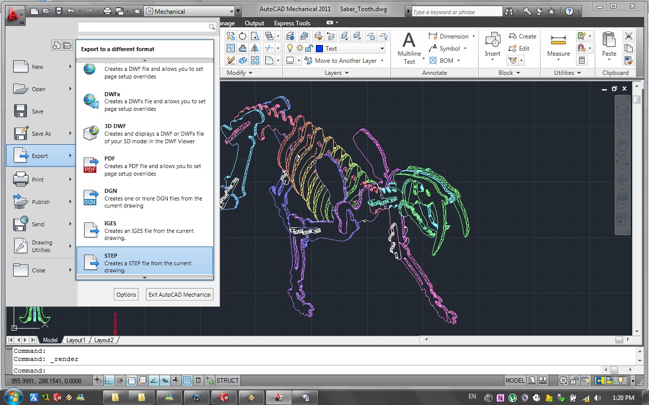

In 2004, type stepout at the command line. It also has igesout, stepin and igesin. Like I said, thiat's in 2004, not sure about other versions. Also, it the LT version does not support these commands.
Yep JE but that's Autocad Mechanical!!
stepout didn't work on the command line in 2012 just tried it there after reading Dan answer.
Sometimes .STEP files can be problematic. Not all the time, it really depends on the file's contents. In my case -using IV2011, either that file wont load or maybe a crash will occur. So it has to be treated in AutoCAD. Here, I'm using AutoCAD Mechanical 2011, and it can export/import .STP files, I don't believe it will export .STEP formats. Here, I'm not exactly sure what the technical difference is, except to describe the STEP format as some kind of "assembly" file format. From time to time the .STEP format will bring problems on the other side, import that file into another CAD program. On occasions, I have to explode the blocks in those files, to get 3dsolids, may have to explode reference blocks several times in order to get everything into 3dsolids. A downside is the file size can get get huge in the .STP format.

Stepout worked fine for me.
AutoCAD is Acis based. So the best way is to im- and export data is a .sat file. Many years ago, there was a free online translation service between .x_t(Parasolid), .sat (Acis) and .stp (AP214 and AP203) at STEP Tools INC. It would be great for all engineers, if GrabCAD could offer such a service.
