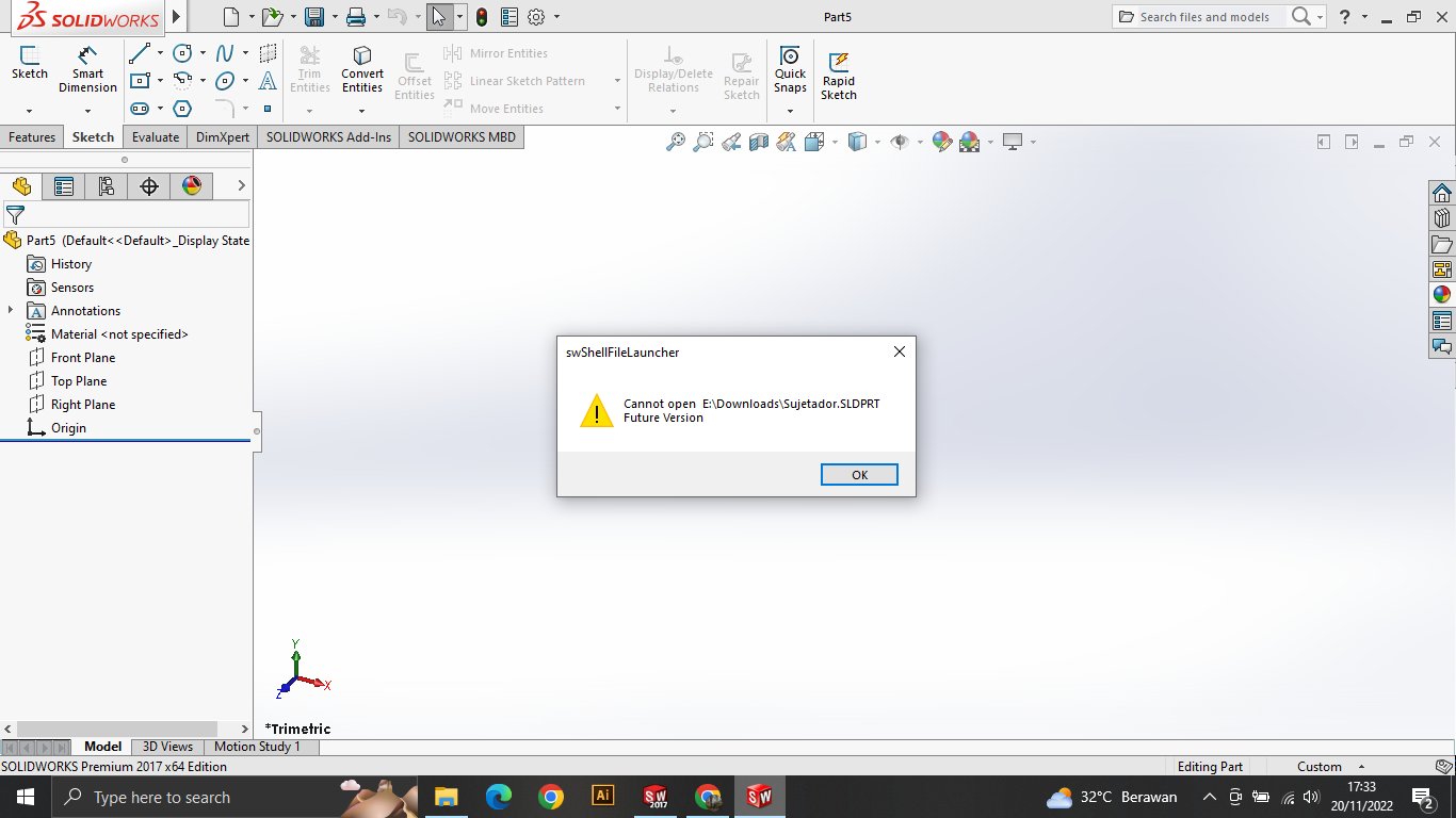

how to fix cannot open template ?
I just downloaded the part template here, for me to study. but there are many parts that I download and can't with the following description. what's the solution ? I'm very new to learning this solidworks application, thanks for those who have helped
2 Answers
I am not a SolidWorks user, but interpreting this message I would assume that the file is saved with a version newer than the version you are using
File you are trying to open is made with a newer version of SW than you have.
1) you can open it in eDrawing, but you won't be able to edit it
2) you can convert your sldprt file to step using workbench, then open it in SW and apply featureworks
https://grabcad.com/questions/how-do-i-convert-a-sldprt-file-to-a-step-or-iges-file
