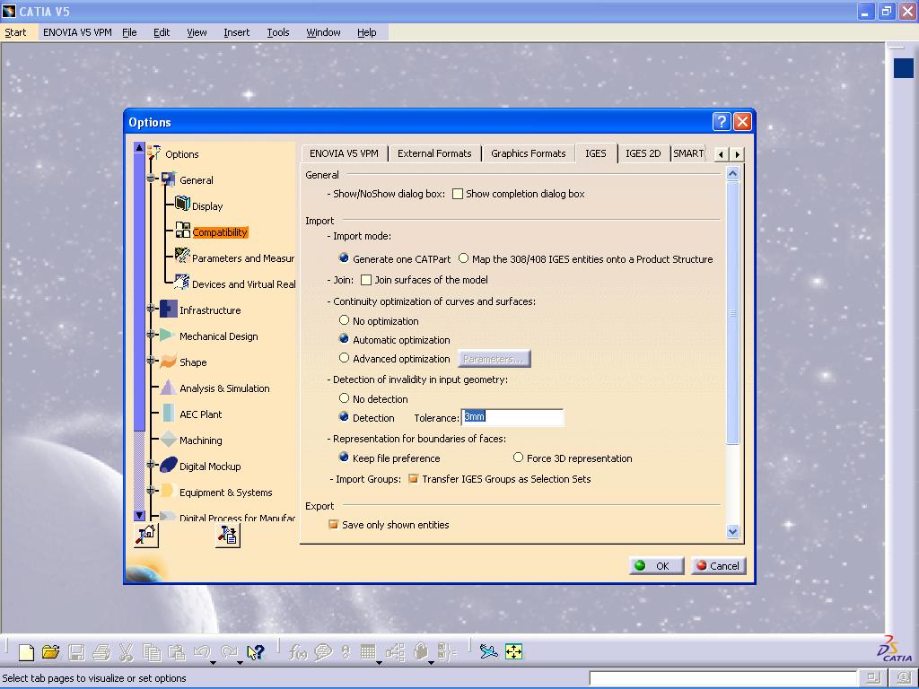

1.Create model in catia
2.Tools-->Options-->General-->Compatibility-->IGES-->Representation Mode-->Activate Sold-Shell instead of Surface or B-Spline
3.Save as .igs

Save catia file in any of the neutral formats such as in IGES format or STEP format or in parasolid. after saving in the neutral format you can easily import the files in any of the analysis tools
Based on my experience with ANSYS APDL and import, the best results (for import) I obtained always using parasolid format instead of other type.
