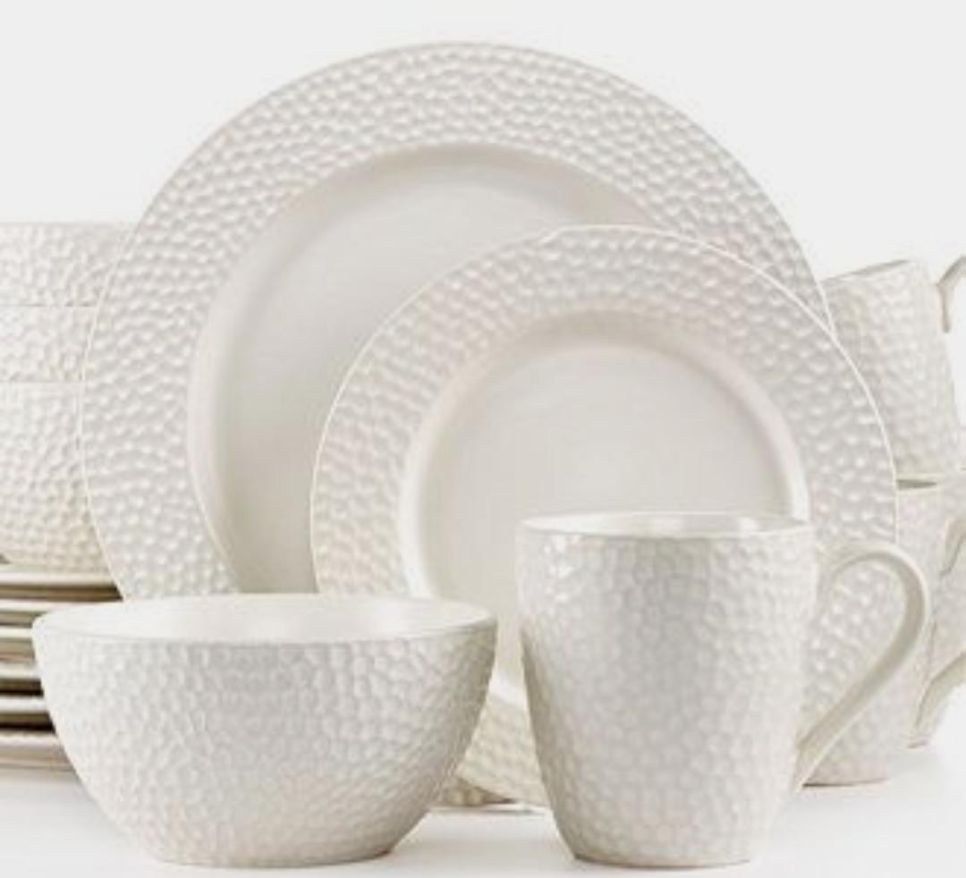

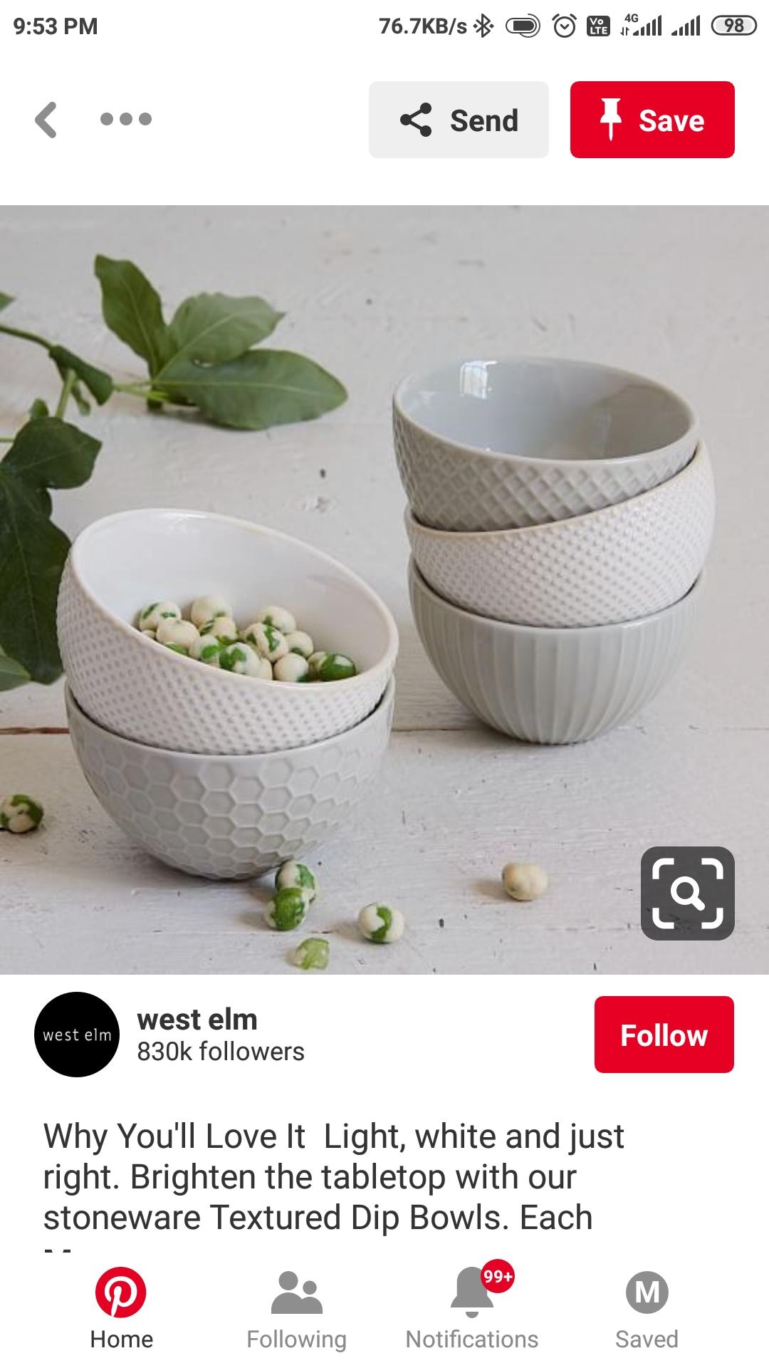

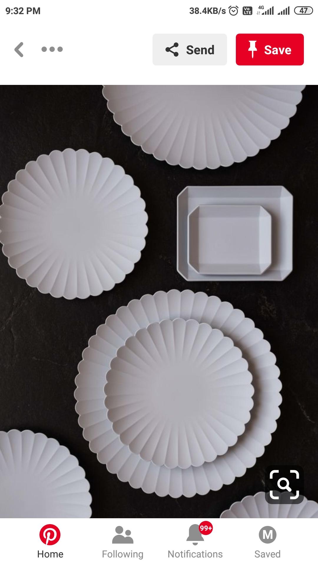

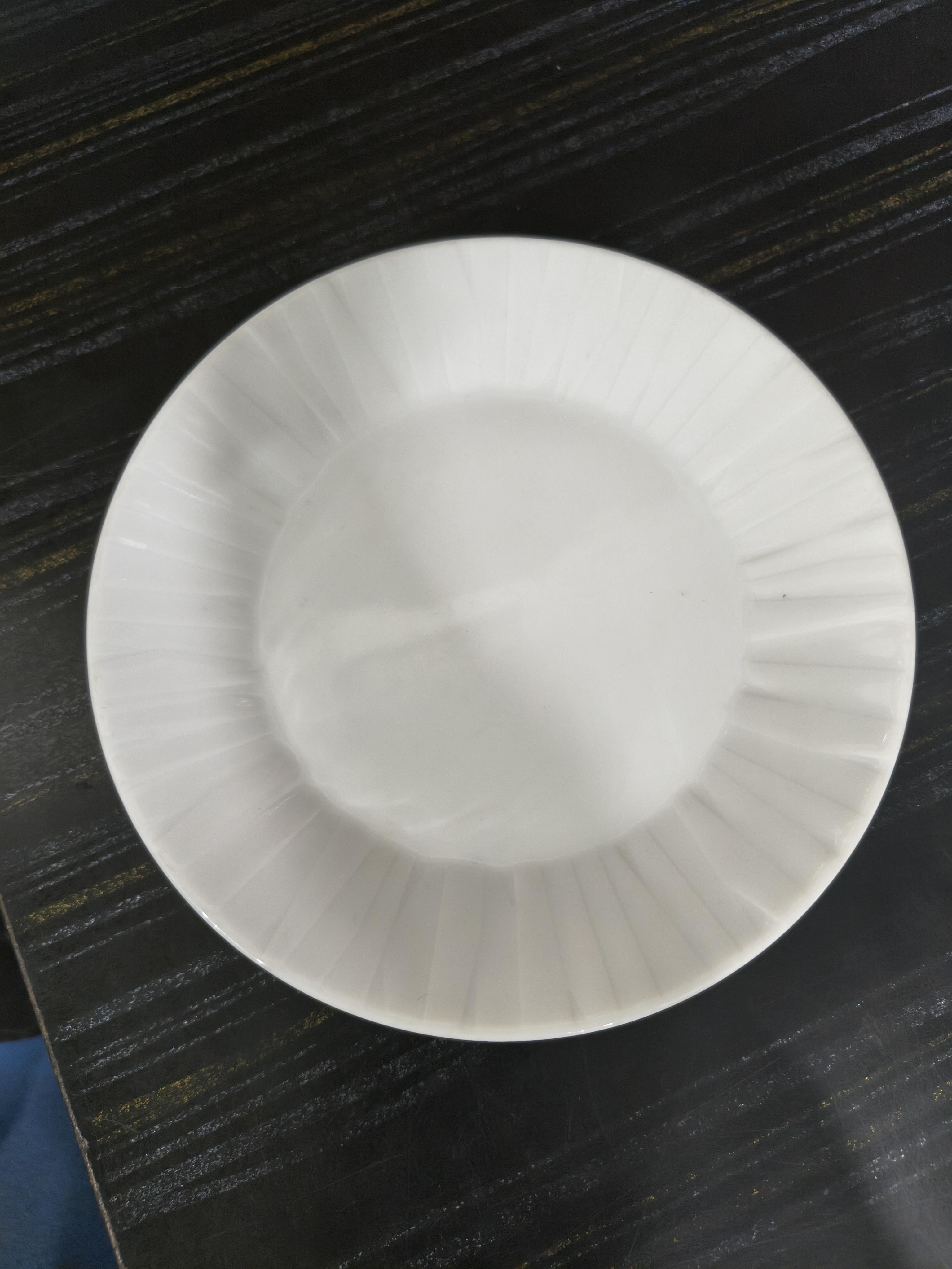

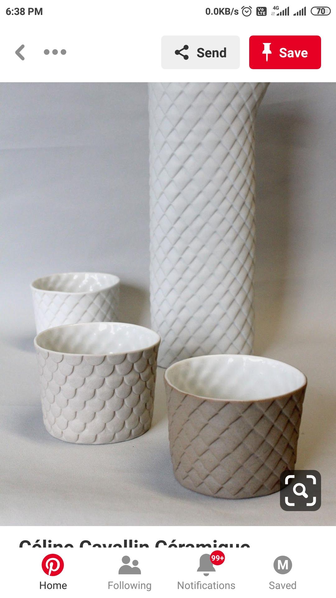

Can anyone help for me how to make a this type pattern in mugs and cups in solidworks please help me.

To create patterns on mugs or cups in SolidWorks, first model the basic shape using **Revolve** or **Loft**. Then, use **Wrap** or **Project Curve** to apply the pattern onto the curved surface. You can sketch your design (text, logo, or pattern) on a flat plane, then use **Wrap (Emboss, Deboss, or Scribe)** to project it onto the mug’s surface. For repeating designs, use **Circular Pattern** around the axis. This allows precise placement and clean curvature on cylindrical surfaces.
