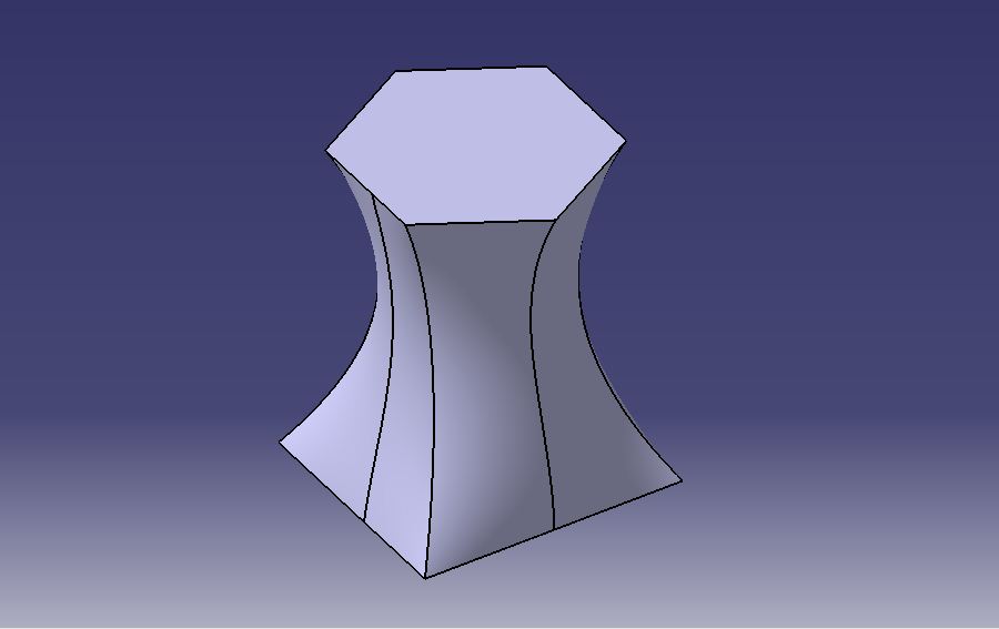

how to make a multi section solid on this sketches

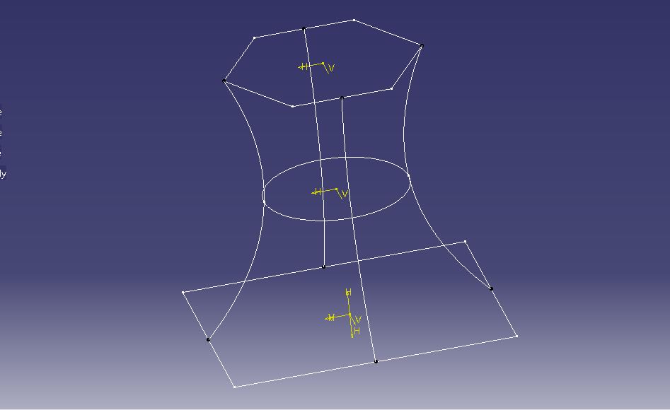

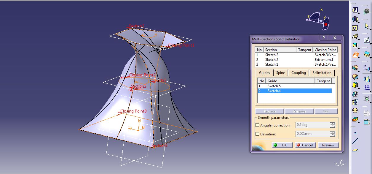

when i am making a multi section on a rectangle and circle it accepts but while making a multi section on a hexagon and a circle it shows some error .......the question is to make a multi section solid on a hexagon on the top after a circle in the middle and a rectangle at the bottom i am applying guide curves but then also it is showing some errror..............just see the attached catpart file after applying four guide curves error is coming i have attached the pic
5 Answers
check it here .. its in part design.
Closing point should in same direction and same line point... please check my model specifically closing point.
yes sir u whre right the closing point of the secctions where not in the same line
just see my model pic

hi... please go through the attached file.
Regards
Vinoth

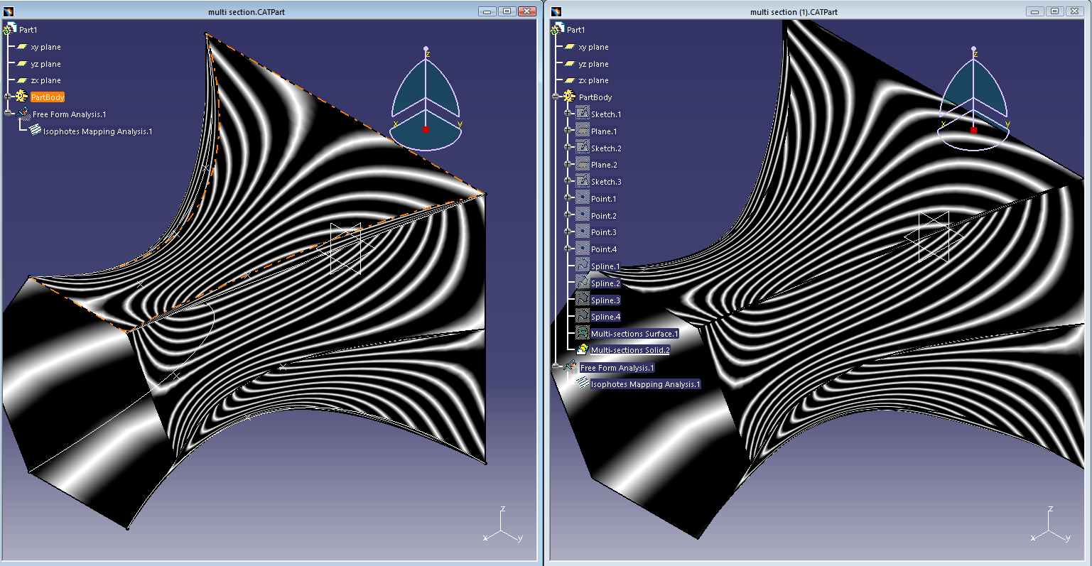

Hello SATYAM,If use coupling, could get better surface quality.
