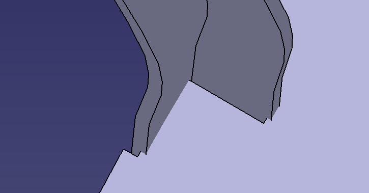

Hi,
I made multi section solid, and then when i do removed multi section solid it shows me a clash. It is the same two profiles, same two guide lines..
Any solution?
2 Answers
Please upload the file
Dear Nikola Rajić
You can use the same guide curves for remove multi section solids but when you use the same profile which you used for multisection solids there might be no solid part left because entire volume will be removed this might be an issue
else you might not have placed the closing point evenly between two profiles.
