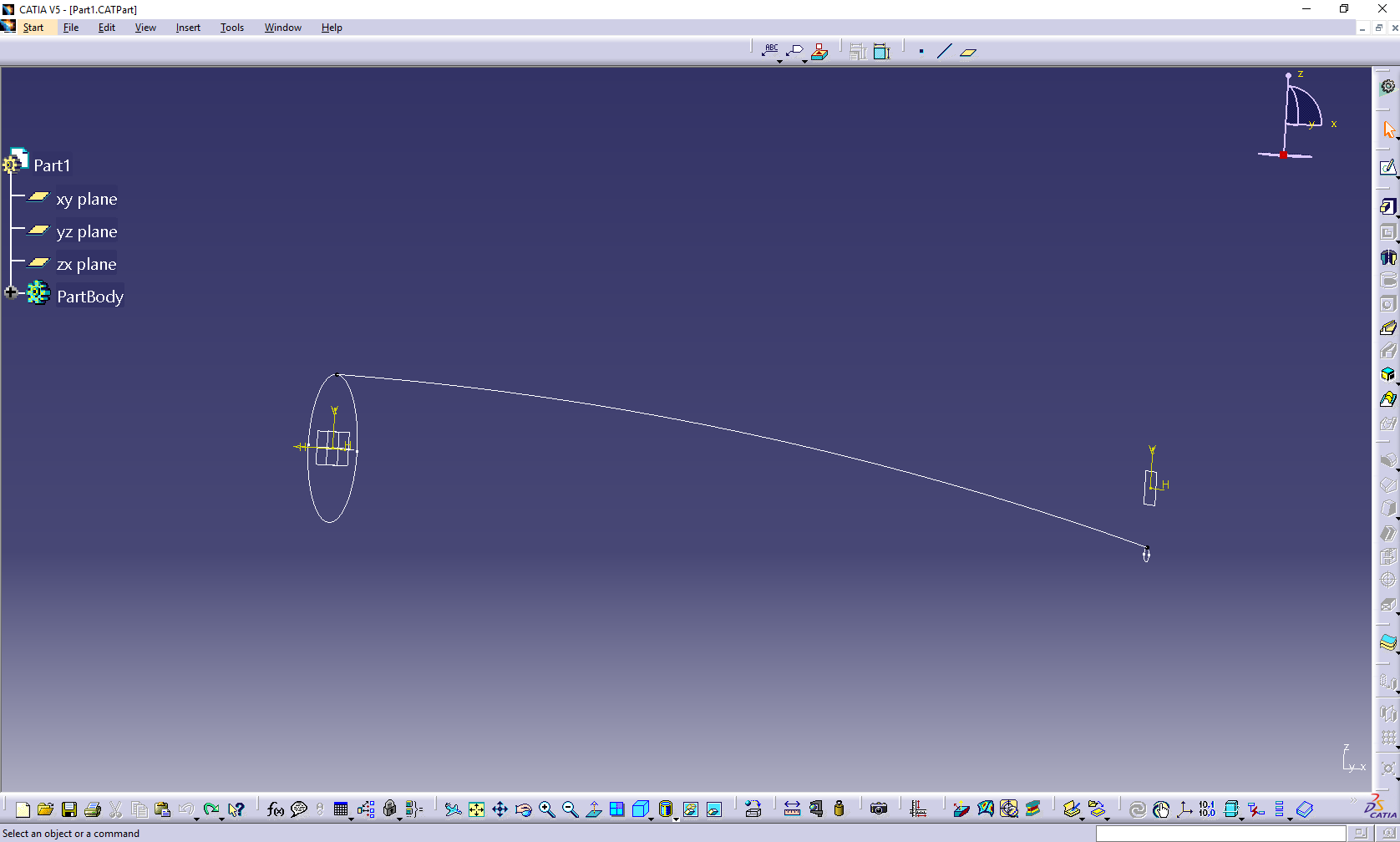

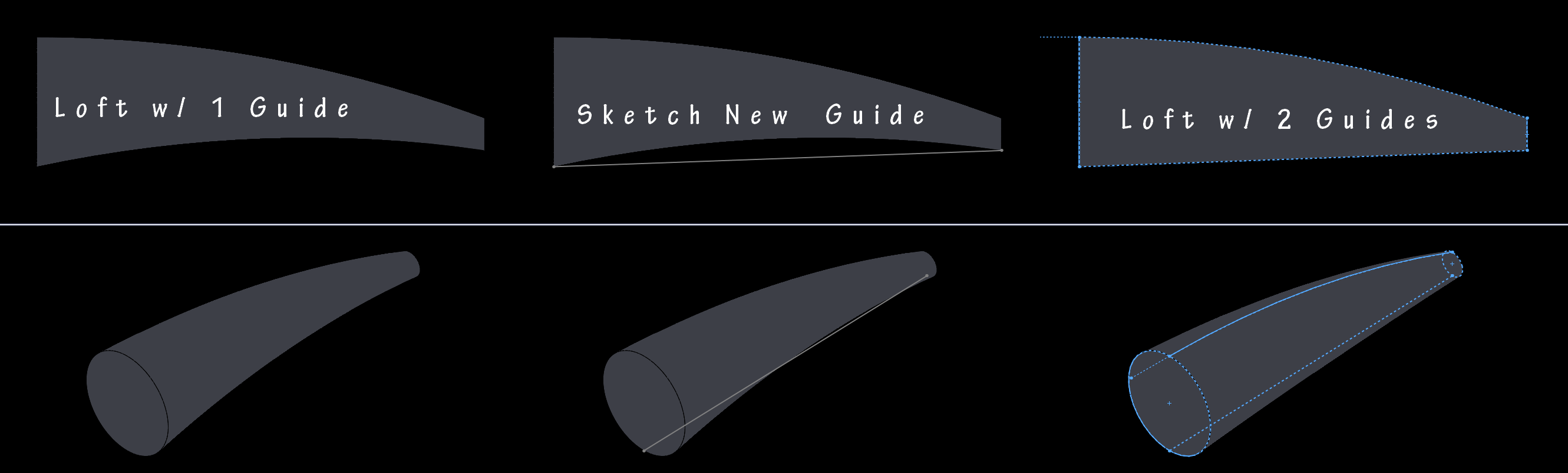

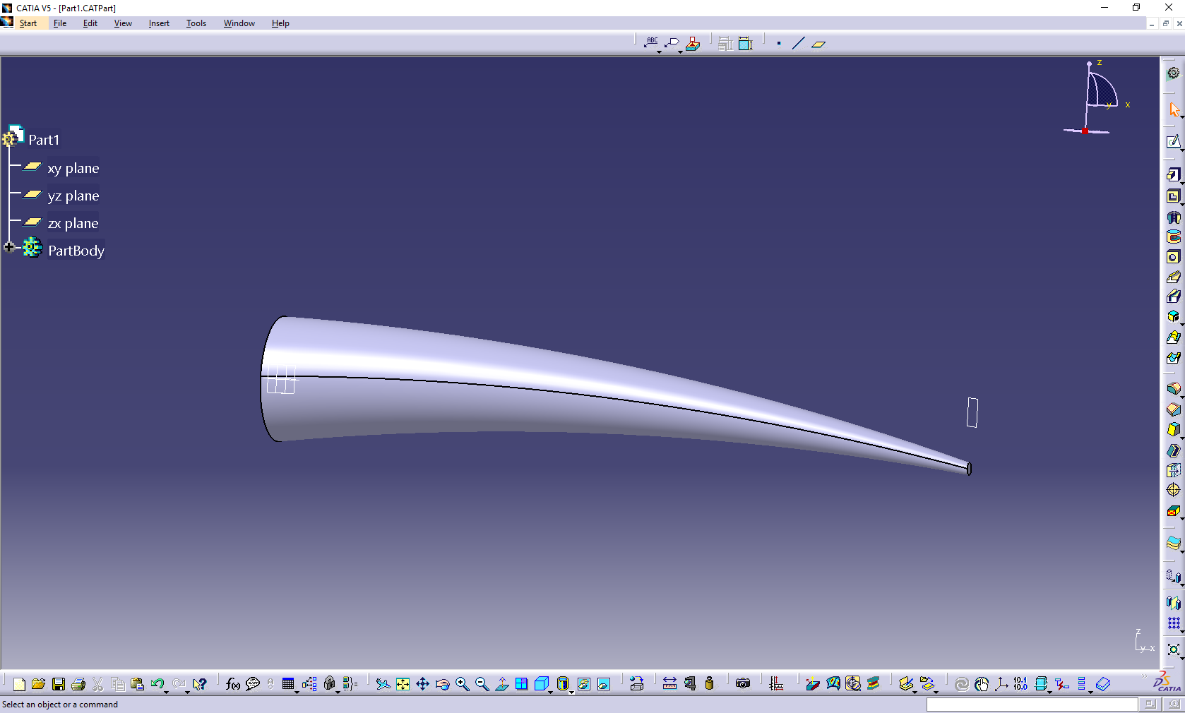

Multi Section Solid harley patterson 8 May, 2018 10:40 PM Hello I am trying to create a curved multi section solid like the image attached but with the bottom part being level between the two circles. Any help would be appreciated. Problem.png sketch.png 2 Answers FredSWUG Answered on 8 May, 2018 10:59 PM Can you add another guide curve? It looks like the shape is following the curved guide well. Perhaps add a 2nd guide at the bottom which is a straight line? Image attached Untitled 1.png harley patterson Answered on 13 Jun, 2018 12:11 AM Thanks for this answer, this worked for me and i achieved the shape i wanted.
