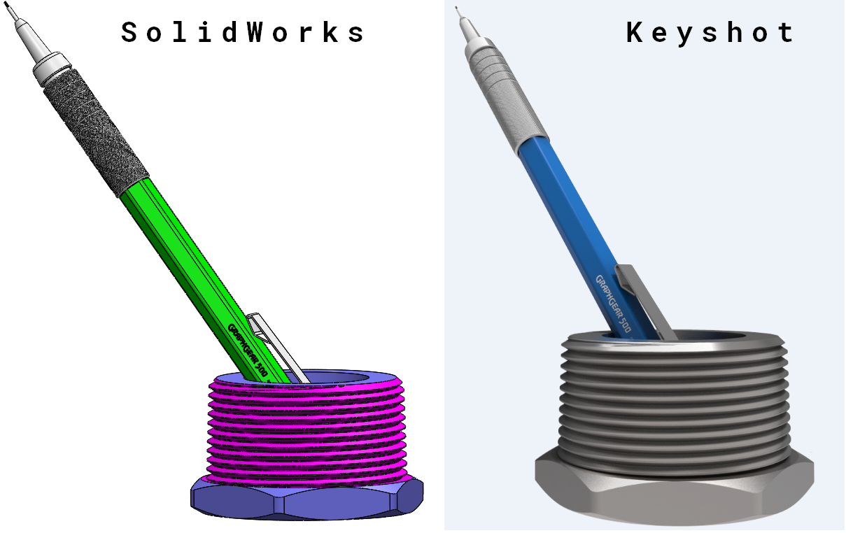

how to make a section view from a closed model and render it in keyshot venkata karthik 15 Apr, 2016 06:53 AM consider a hollow cylinder for reference and i want to make a section of the cylinder in keyshot and also render it in keyshot, can it be possible 2 Answer FredSWUG Answered on 15 Apr, 2016 11:42 PM I don't think so. You'll need to section the cylinder in another program, then import it into Keyshot. FredSWUG Answered on 16 Apr, 2016 09:21 PM Here is an example of colors in SOlidWorks converting to different colors and materials in Keyshot. Untitled 1.png
