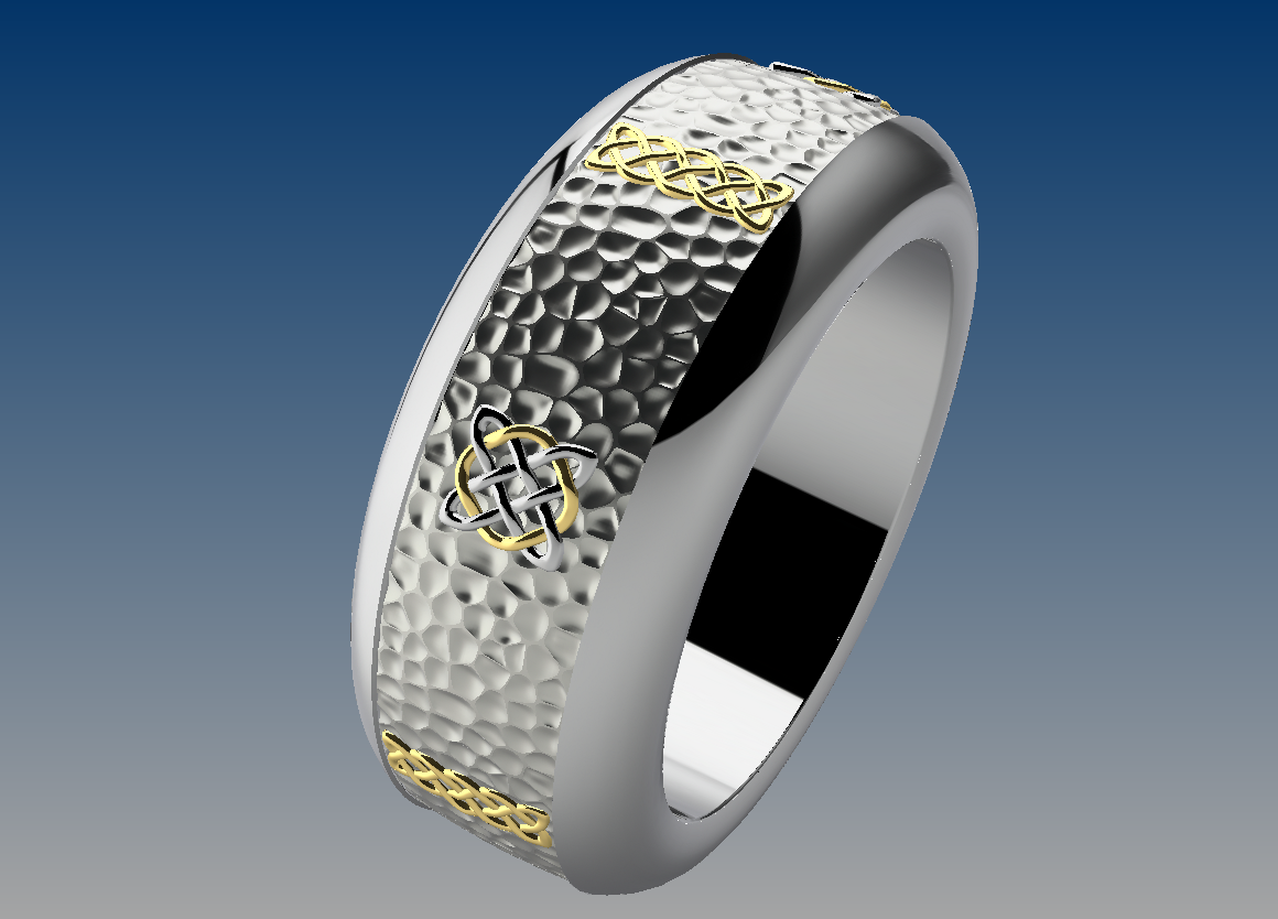

Hi there, I'm trying to make a silver ring in Rhino and it needs to have hammered finish right on the model (not texture) so we can print it in wax and cast it.
I have no idea, however, where to even begin to make the ring surface hammered. I'd really appreciate any help.
Thank you.
P.S. attaching img for reference.

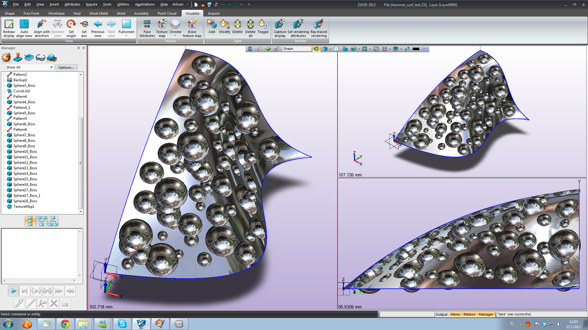

Hammered surface test this is what I could do with my software, it's not perfect but I'm sure you could get it right
