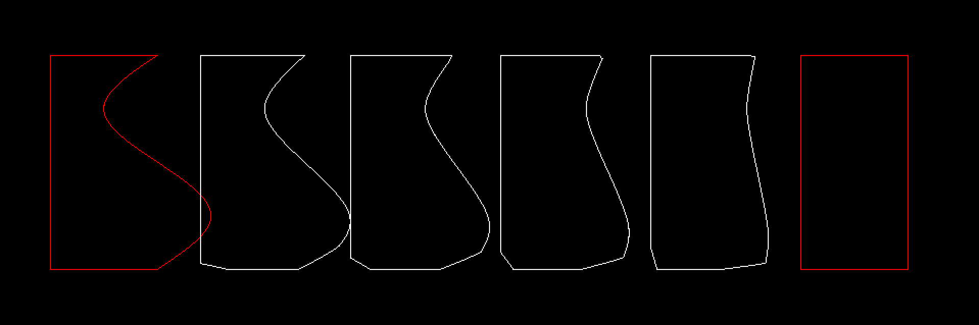

I need to create a lot of sketch , basically an open spline, with morphing from one shape to another one with n iterations.
Solidworks is not supporting such function, but if somebody as done that using third party freeware then importing into solidworks, please let me know .
Example of line morphing:
https://qcad.org/en/tutorial-morphing
