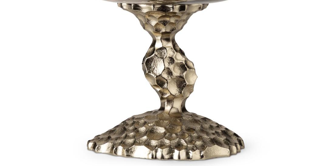

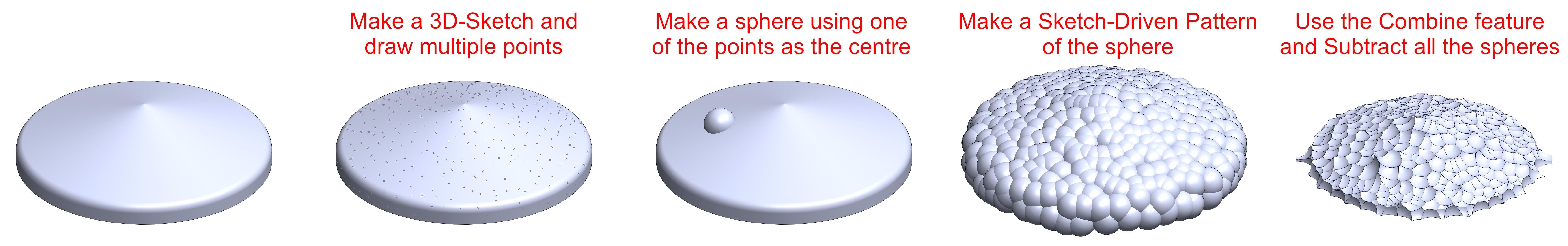

How to model this nima nimax 14 Sep, 2020 05:17 PM Hi everyone How to model something like this pic? 1599924802.jpg 1 Answer Yahya T Khedr Answered on 14 Sep, 2020 07:56 PM As CADCloud said, the most reasonable way is 3D Scanning. If you still want to model it in SW, check out these steps: Steps.jpg
